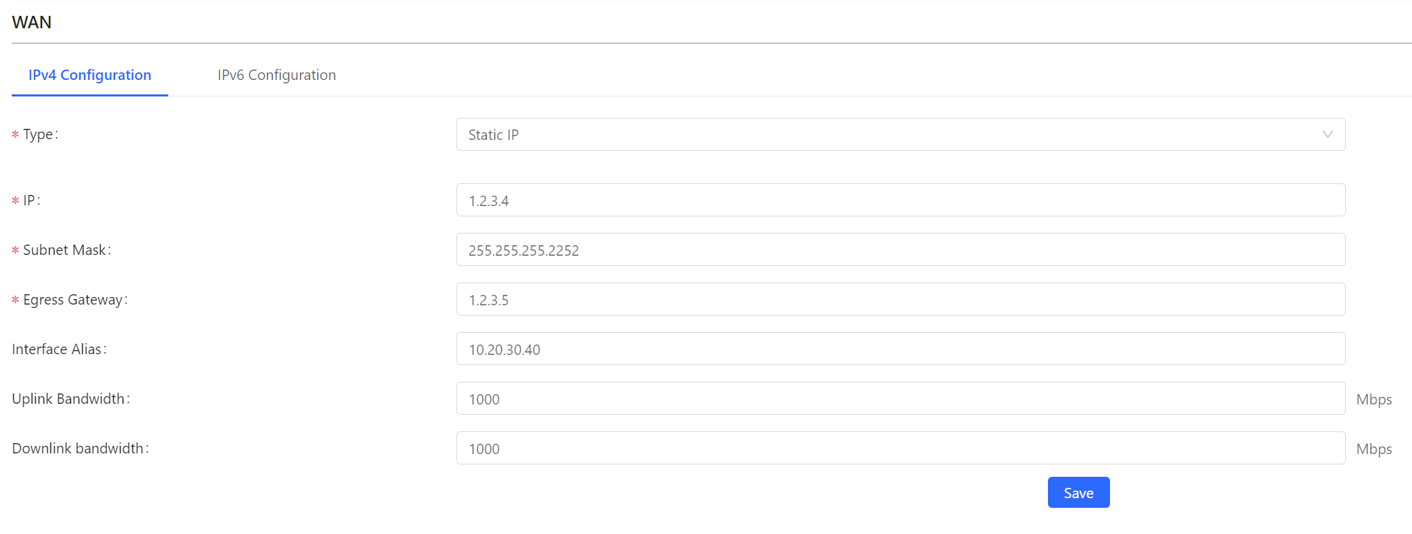

Hello, I would like to solve a question, some internet operators use the CGNAT method and when we ask to leave the operator's own Router as Bridge, so that we can use the Reyee router in my case the (RG-EG105GC V2) they send, for example, Static IP.
Example:
IP - 1.2.3.4
Mask - 255.255.255.252
GW - 1.2.3.5
Alias - 10.20.30.40
On the Ruijie cloud, the “Interface Alias” option appears, but even though it indicates the ALIAS IP offered by the operator, we can't connect to the internet.
In this case, how could I configure the Reyee router to work in this IP ALIASING mode?
Or which Reyee series should I buy in order for this configuration to work?
Thank you.

Hi sir,
RG-EG105G V2 cannot support configure Multiple IP addresses on same wan port, If it is a different vlan for the static ip , NBR and ruijie EG can support it.
