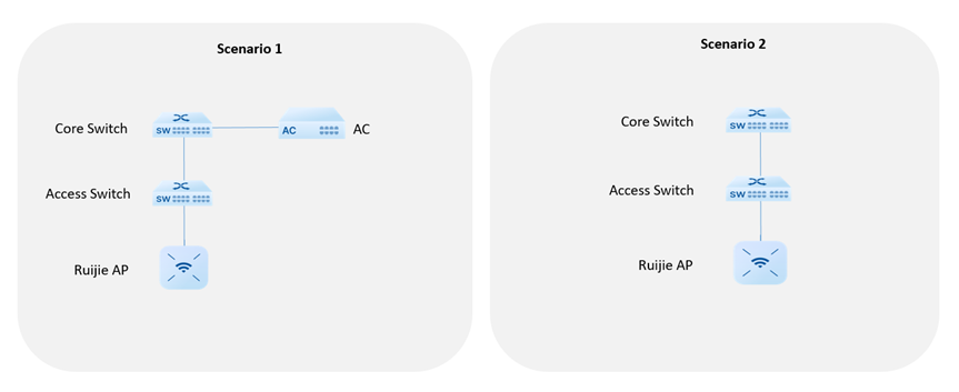

2. Topology:

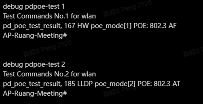

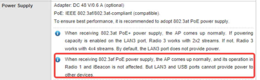

5.5 Low PoEPower of the AP
Insufficient AP power may cause RF ports to operate abnormally or restart, leading to client disconnections.
Confirmation method:
1. Run the following commands to check the AP PoE power:
debug pdpoe-test 1    Hardware PoE negotiation
debug pdpoe-test 2    Software PoE negotiation
2. Check the AP hardware installation maroguenual to confirm the power supply requirements of the AP. The following uses RG-AP850-I(V2) as an example. When RG-AP850-I(V2) is powered by the IEEE802.3af standard PoE, some RF ports cannot go Up.
Handling suggestion: Use a power source equipment (PoE switch or PoE adapter) that meetsAP power supply requirements.

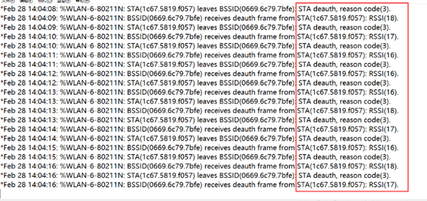

5.6 Client Active Disconnection due to an Error
If as pecific client actively goes offline, it may indicate a fault with that client.
The output of the show logging command on the AP displays client de-authentication and disassociation events, as shown in the following figure:
1. If only a specific client is experiencing issues, check that client directly. Some clients may automatically go offline due to power-saving mode.
2. If multiple clients of the same model are failing, there might be a compatibilityissue. Contact Online Technical Supportfor assistance.

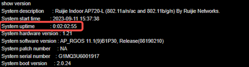

2. The AP restarts.
Run the show version command to check the device uptime and see if the AP restarts when the client goes offline.

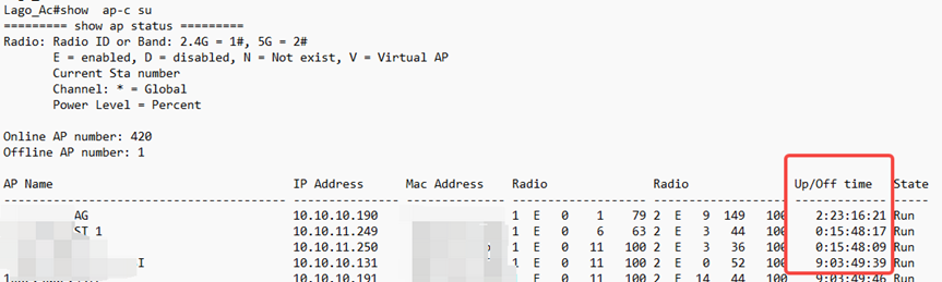

3. In Fit AP mode, the AP is disconnected from the AC.
Run the showap-c su command on the AC to display the online status and online time of the AP.

5.8.1 Fit AP + AC Scenario
Data collected on the AC:

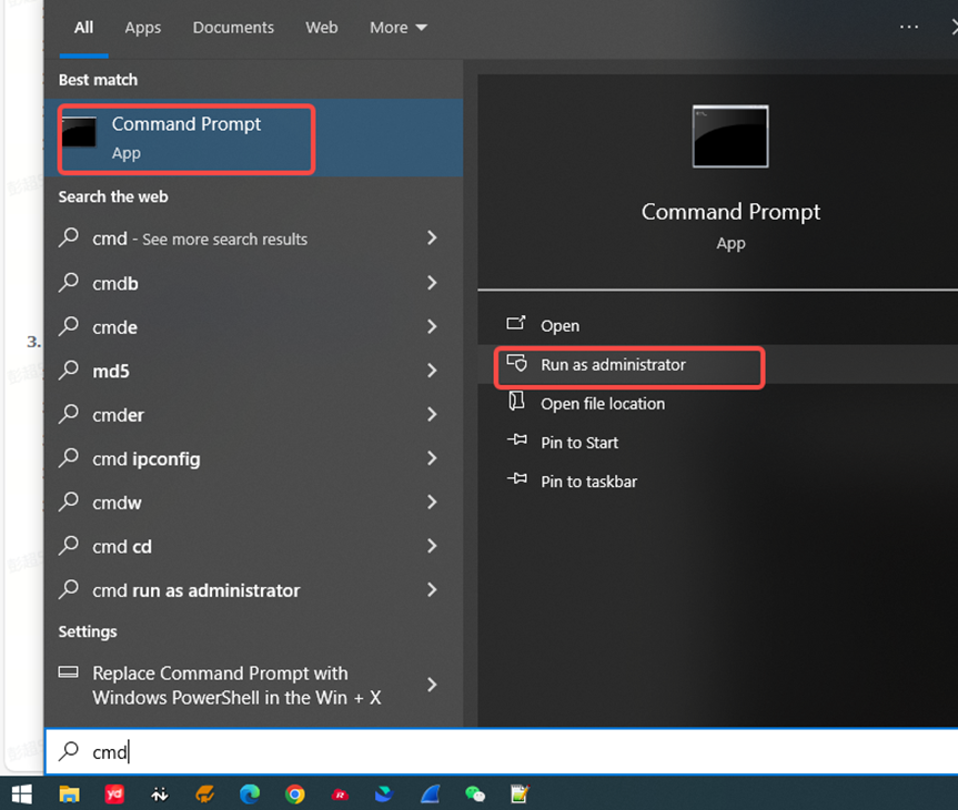

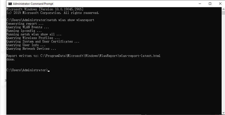

5.8.3 Collecting Information About a Windows Client That Goes Offline Abnormally
If a Windows client actively goes offline but the reason is unknown, you can collect the corresponding network adapter association logs of the Windows client. During troubleshooting, ask the customer to collect such offline logs, such as the logs with reason code 1 or 7 on enterprise APs. The method is as follows:
Open the Command Prompt as an administrator and run the following commands:
netsh wlan show wlanreport
The generated report file is wlan-report-latest.html.
