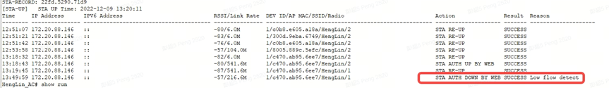

2.2 Client No-Traffic Detection Enabled
On the AC, run the show wlan diag sta sta-mac xxx.xxx.xxx command to display the client disconnection cause. (Run the wlan diag enable command on the AC to enable the WLOG feature before the client disconnection.)
The client is disconnected because no traffic from the client is detected, as shown in the following figure.
You can also use the following commands to view the client disconnection cause.
Debug web cli
Show web-auth syslog ip xxxx
(clientIP) — Query the client online and offline records.
The following figure shows the collected information.
The Event and cause fields provide an overview of the offline reason. You can further confirm the cause by checking the Event field.
