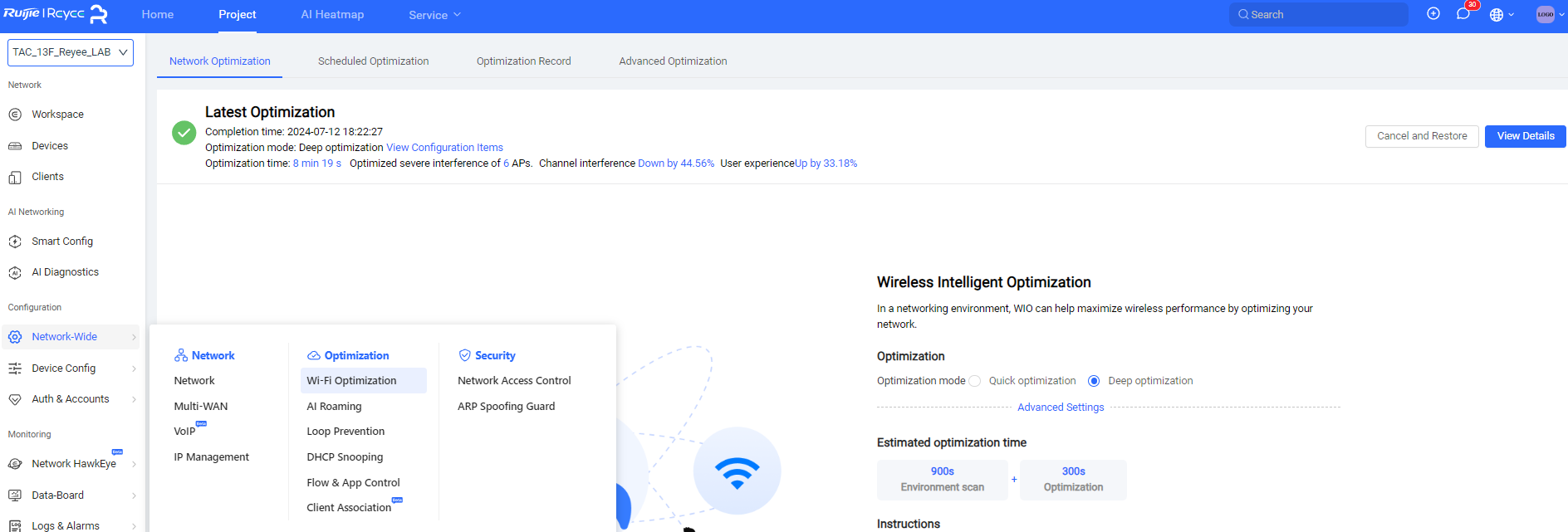

If you are managing your device via the Ruijie Cloud, you may try the WIFI optimation feature in your project. It can adjust channels, RF power, roaming sensitivity etc. of your AP units automatically to ensure better wireless experience.
If you want to configure the channel manually, you may consider nesting the channels of your AP units in the following pattern according to their physical locations to reduce interference.
