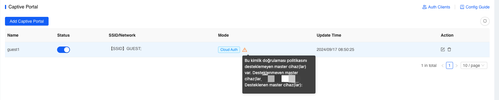

Hello Friends,
I have 4 RAP2200(E) devices, I installed them, I created a project on the ruijie cloud portal and I broadcast wifi with 1 SSID, I use it in whitelist mode.
I want to open a separate SSID for guests and use it with code authentication with captive portal, but when I create a second ssid, I cannot connect at all.
I tried hard, I created a vlan 20 port on my sophos firewall and gave full permission to this vlan20 as lan->wan, I created a vlan20 on my hp switch and marked them all as tags, but I cannot do the operations on ruijie.
The SSID is visible, when I say connect, it cannot connect at all. I only have 4 AP devices, nothing else, do I need an extra router or something else, can you help me?

Dear Sir,
Thank you for sharing the link with me.
After checking, There are no other Ruijie/Reyee device in your project and RAP 2200(E) is not support with standalone Captive Portal. So when you bind portal auth on the Guest SSID, it might not going well.

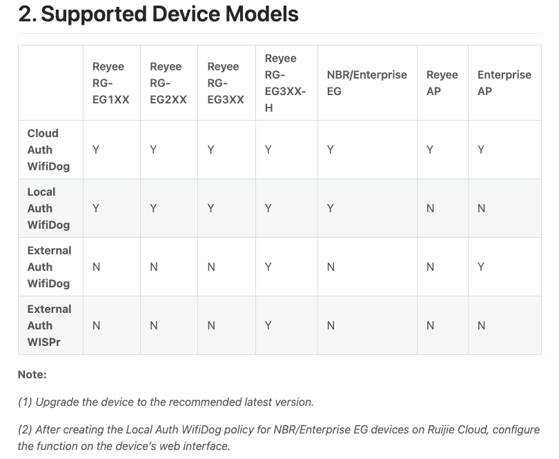

Dear Sir,
You may check this form:
