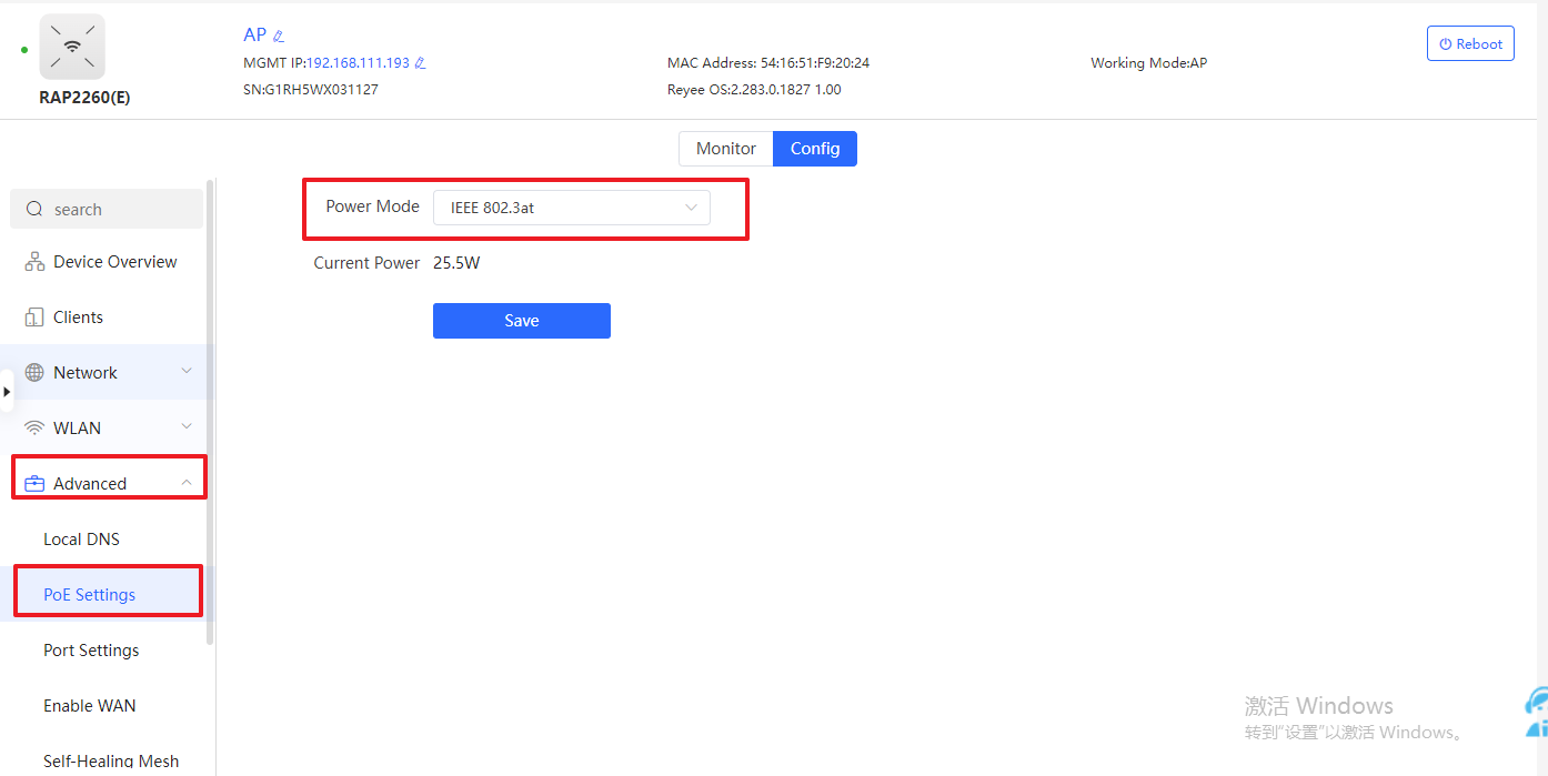

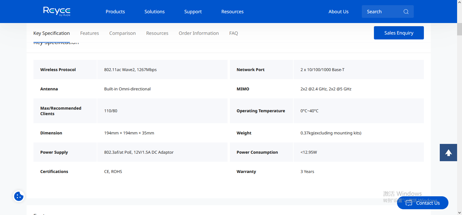

Please check the AP power supply, whether it meets the standard to power on the AP. RAP2200(E) can support 802.3af/at PoE, 12V/1.5A DC Adaptor.
If you use standard power supply, but the alarm when the power supply can support standard 802.3at protocol
still prompts. You can try to change the AP power mode to 802.3at manually on the following page:
Note: You can change to 802.3at power mode only when the power supply can support standard 802.3at protocol, otherwise the AP will not be powered on normally.
