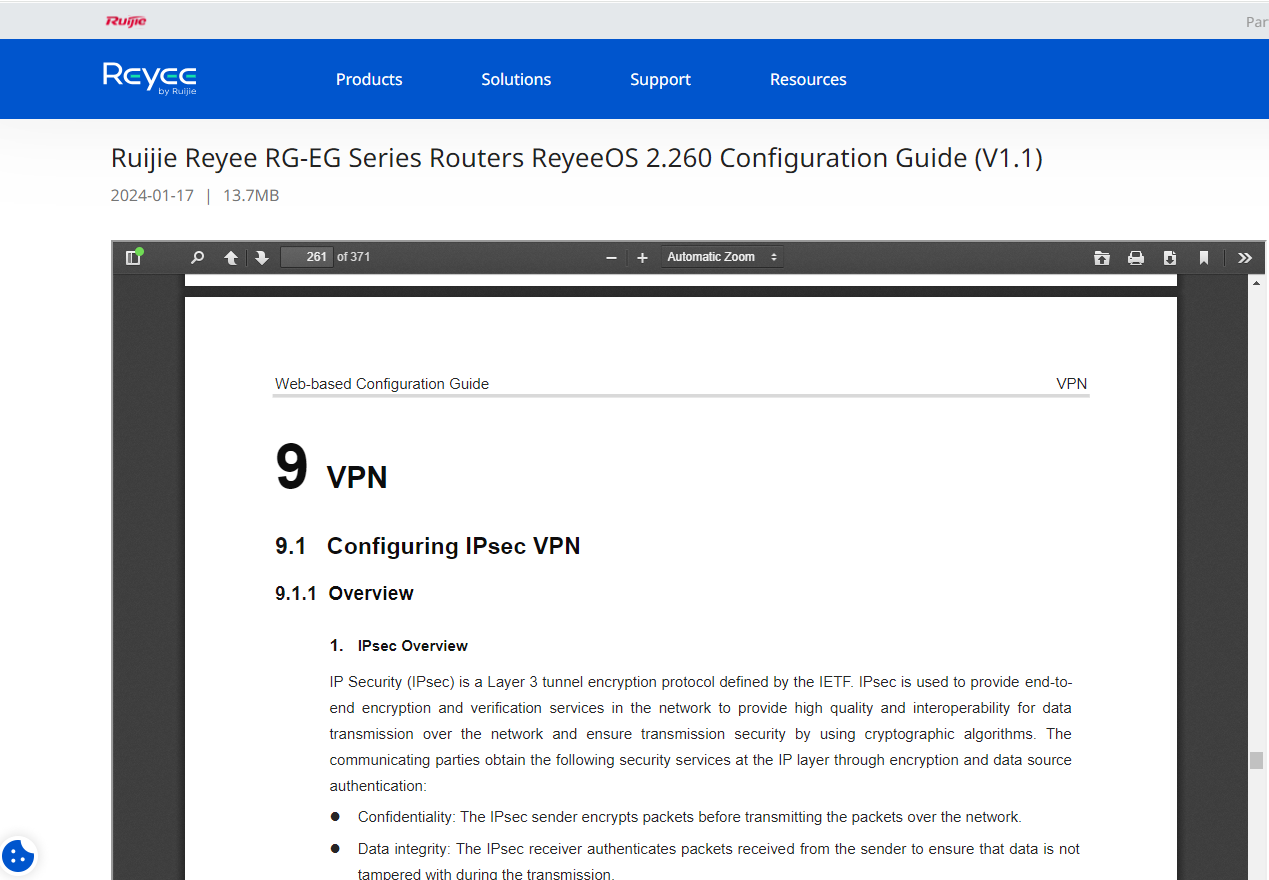

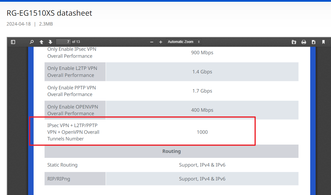

Hi sir, it can support different branches connect HQ.
https://reyee.ruijie.com/en-global/resources/preview/eg1510vsdatasheet/
