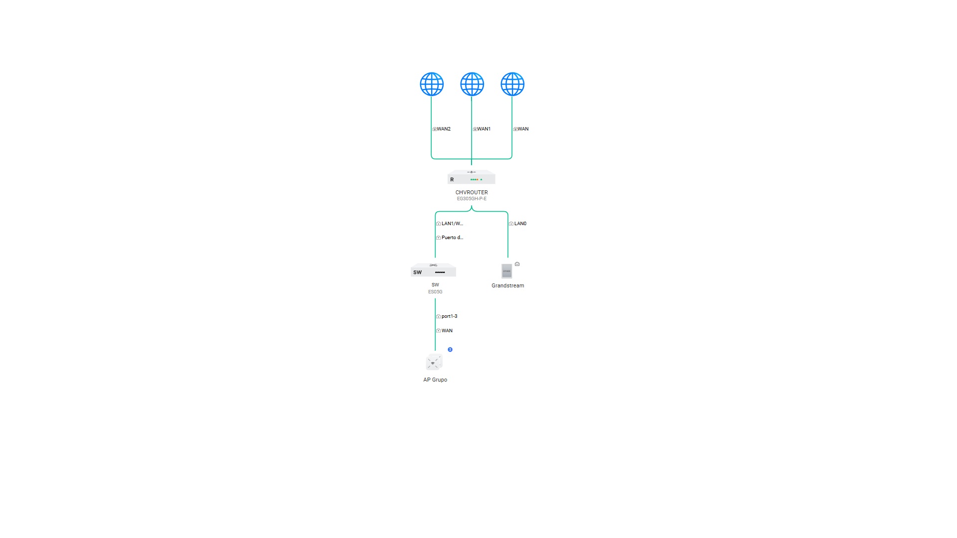

Hola tengo un router EG305 con 3 WAN un SW
ES205GC-P y 3 AP RAP6262G. El SW no he podido sincronizarlo en el Cloud. todos los equipos estan actualizados a la ultima versión de Firmware

Hi sir,
May I know your topology, is there any firewall in your environment?
The synchronization configuration of our devices with the cloud needs to ensure that TCP 80,443,25857 and UDP 3478,3479 are available on the network.
Can you check on that and refer to us?
