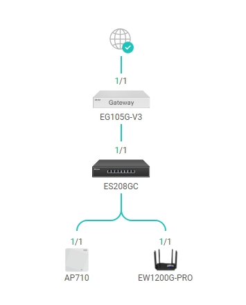

I have problem when one of my computer (Windows 10) connected through lan either in router (EG105G-V3) or switch (RG-ES208GC), it will turn off my vpn l2tp ipsec, and my switch will be appear offline in cloud. If i disconnect the lan to that computer, the vpn turn back on and switch turn back online. For the computer i use dell optiplex micro
Topology
Router Switch VPN Troubleshooting Ruijie Cloud

solved, the computer is uploading to google drive and take the whole network bandwidth, and it's looping with failed upload.
Disconnected the pc, change it with new one solve the problem.
web management still available with the gateway, and when enter the eweb, the topology is there all online
