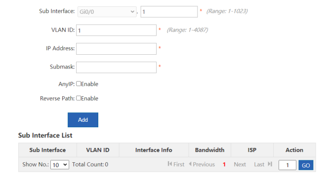

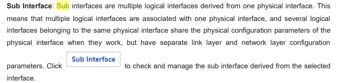

Hi Trusty Hoister,
You can use subinterface.
0 2024-9-24 09:37:50 View all replies

Trusty Hoister replied at 2024-9-26 17:26
What do you mean? So, if i setup the VLAN configuration in router? and plug AP there, It does not  ...
If the address pools of different vlans belong to different subnets, cross-VLAN communication can be implemented. Vlans are used to isolate Layer 2 network communication. Communication between subnets cannot be isolated by VLAN.
But If the subinterface on the NBR is configured with a VLAN TAG, the interface connected to the NBR of AP must also be configured with allow VLAN.
0 2024-9-27 10:15:52 View all replies

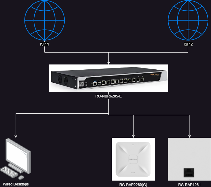

This is what i actually want to do.
In RG-NBR6205-E I'll setup a:
VLAN0 with the subnet of 192.168.10.0/24 - For company devices - SSID
VLAN1 with the subnet of 192.168.20.0/24 - For
personal devices SSID
VLAN2 with the subnet of 192.168.100.0/24 - For
guest connection SSID
and VLAN0, VLAN1, and VLAN2 should be distributed by 2 APs, plugged in to LAN0 and LAN1 of the router.
Now, in 2 APs. They both should have for 3 SSIDs.
  • Company SSID
  • Personal SSID
  • Guest SSID
And every SSIDs have their own specific subnet IP.
  • Company SSID = VLAN0
  • Personal SSID = VLAN1
  • Guest SSID = VLAN2
And when the user is  connected in SSID personal devices — the IP they will get is from 192.168.20.0/24(VLAN1), and they should be allowed to communicate with 192.168.10.0/24(VLAN0) to print. Since printers are in VLAN0.
In other words, cross-VLAN and routing configuration is configured in RG-NBR6205-E; and APs, will only act as wireless connection distributor.
Will that work?
