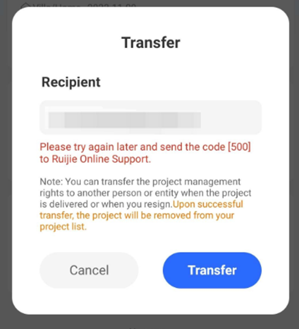

What should I do if I receive a code 500 error while handing over the project on Ruijie Reyee APP? Reply
2771 0 2024-9-27 15:18:27
Fault Phenomenon
Root cause:
1. The recipient and you use different clouds. For example, you use Aisan cloud, while the recipient uses European cloud.
2. The recipient does not exist. Please check if the account is correct.
Solution:
1. Let the recipient create an account on the same cloud to receive your project.
2. Input the correct account.
