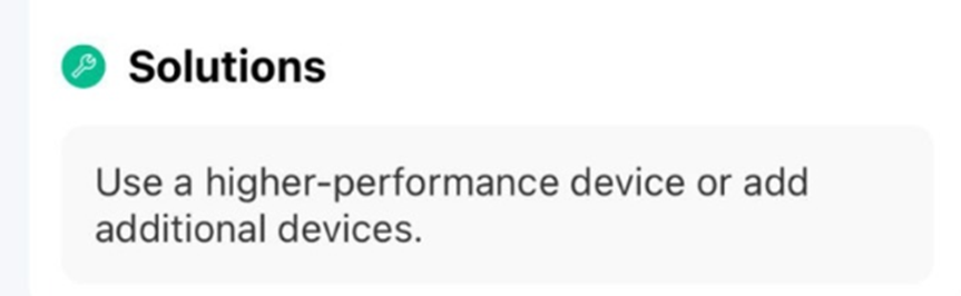

1.Check the warning generated by ruijie cloud. The issue is typically caused by too many clients connected to the same AP.
2. Consider if you can add more APs to the environment or replace the AP with more advanced AP model

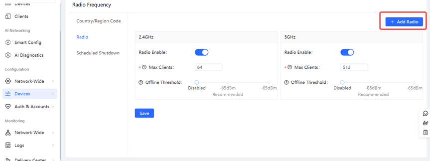

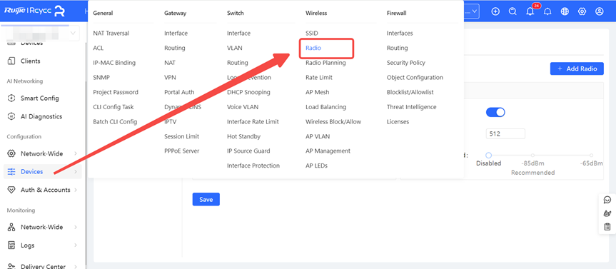

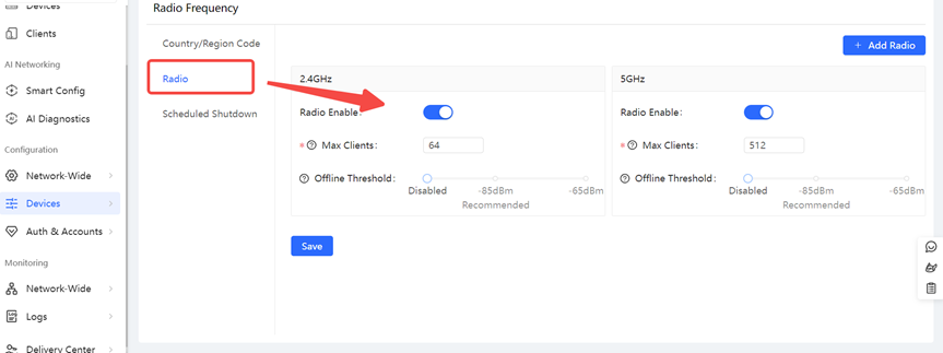

3. Try setting the client number in the Ruijie cloud as the maximum
Try adding a third radio for your AP if your AP supports
Consider increasing the radio transmit power and configuring flow control on your AP to increase its capability to server more clients.
