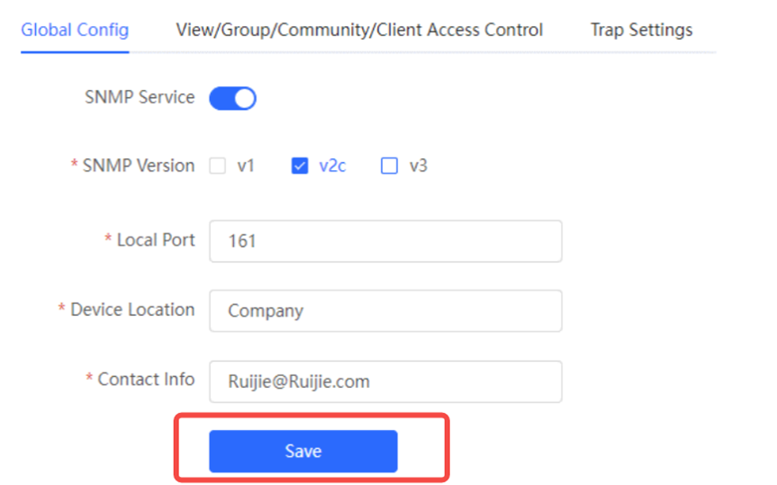

1. On the global configuration interface, select the v2c version, and leave other settings as default. After the operation is complete, click Save.

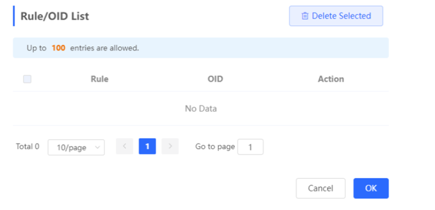

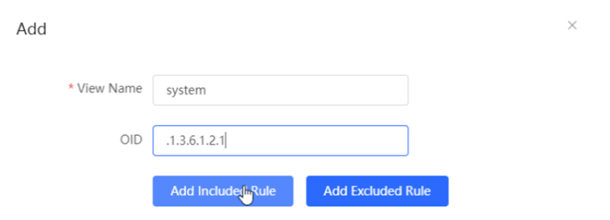

2. On the view/group/group/user access control interface, click Add in the view list, fill in the view name and OID in the pop-up window and click, arnd click OK after the operation is complete.

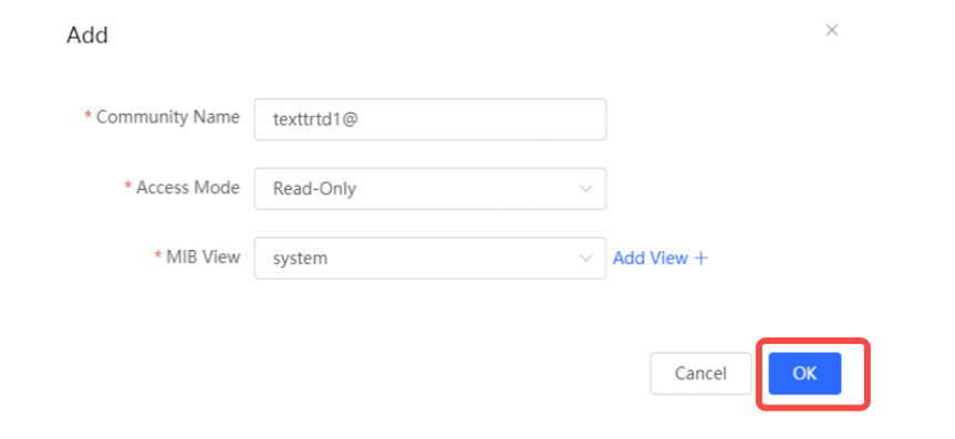

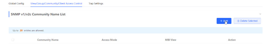

3. Enter the view /group/group/user access control interface, click Add in the SNMPv1/v2c community name list, fill in the community name, access mode and view inthe pop-up window, and click OK after the operation is completed.
