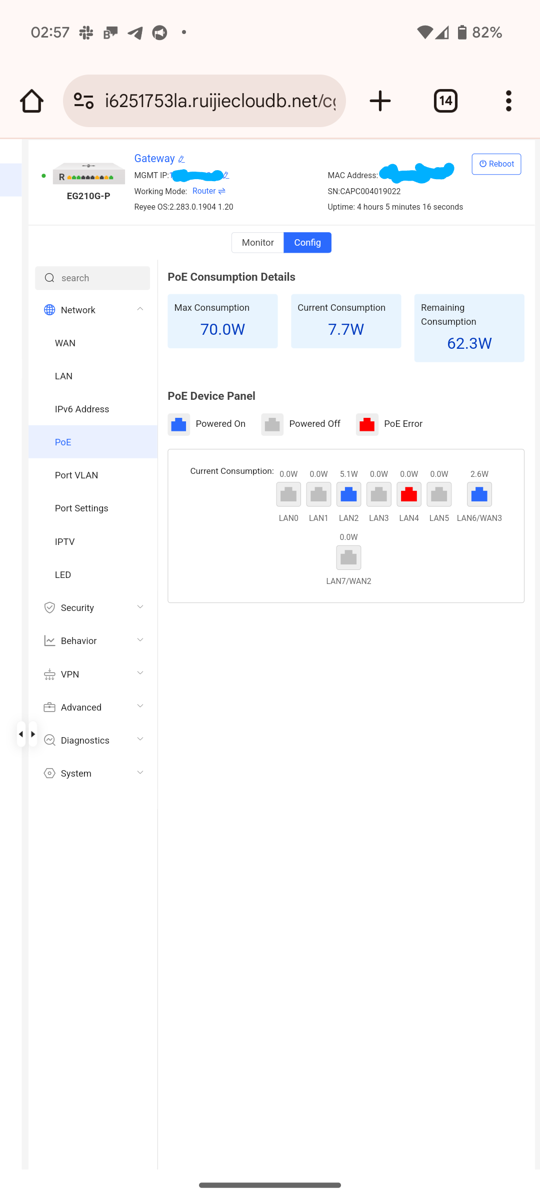

Hello, can you please help me find a reason of POE issue. About 2 weeks some of my POE devices that worked for years stopped working, it's mostly POE extenders / slpliers. At same time AP-180 access point, Reolink camera continue working without issues. I tried to change ports, connect failure devices on cables where other devices work but no luck, I'm still getting POE error in PoE Device Panel of Device config. The only idea I get, it can be related to latest software updates

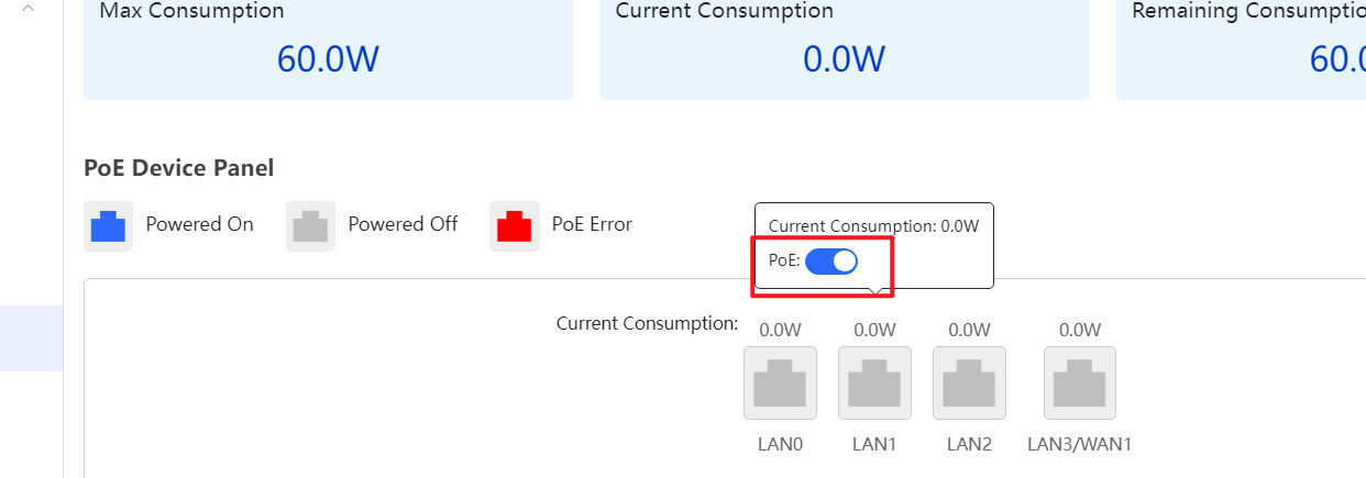

Can you share us a screenshot of the error

I did not try all ports only few that in use, e.g.  I tried connect to port lan2 that currently cannercted to AP-180 and work perfect, also I tried to connect AP-180 lan 4 that fails with particular devices and also have no issue with it. In same time few devices I used before without issues stopped working with POE. E.g. Zigbee concentrator Smlight slzb-06 was working for a long time without issues but stopped, I have 2 same kind (one was in box) and both have same issue, it seems they just cannot initiate POE connection, restarting it continuously, same story with POE expander POE013G and POE splitters PS5712TG both were working no issues

3. Whether you try to disable POE of EG and enable it again?
