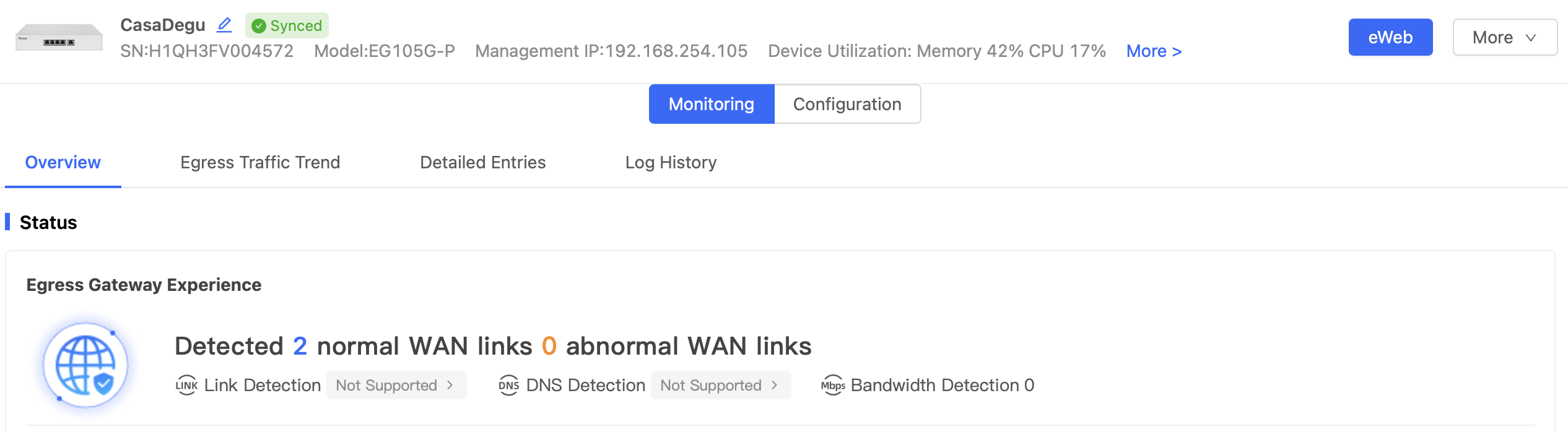

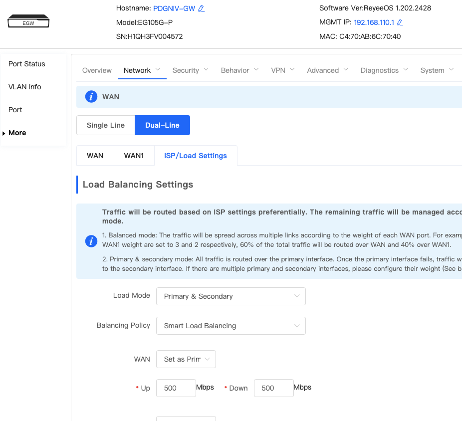

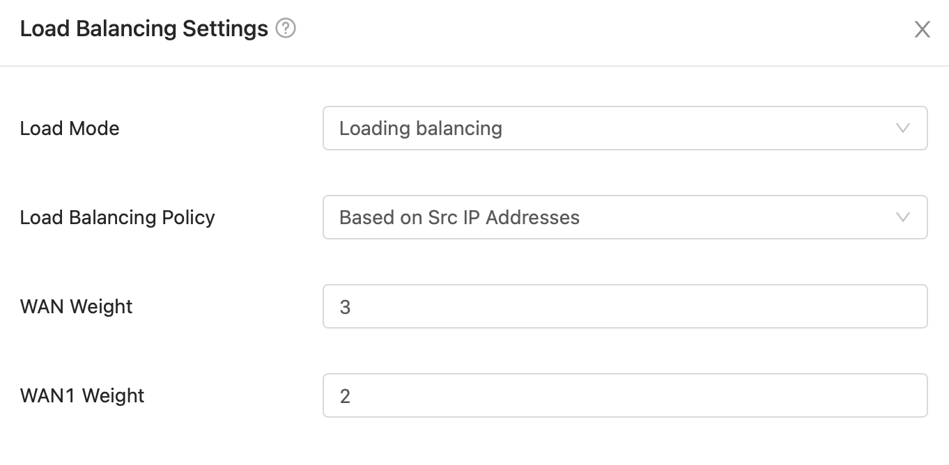

I have two WAN links on a smart load balancing setup, but there were several instances that when WAN internet connections go down, WAN1 does not act as a failover.
I noted here that Link detection is not supported.

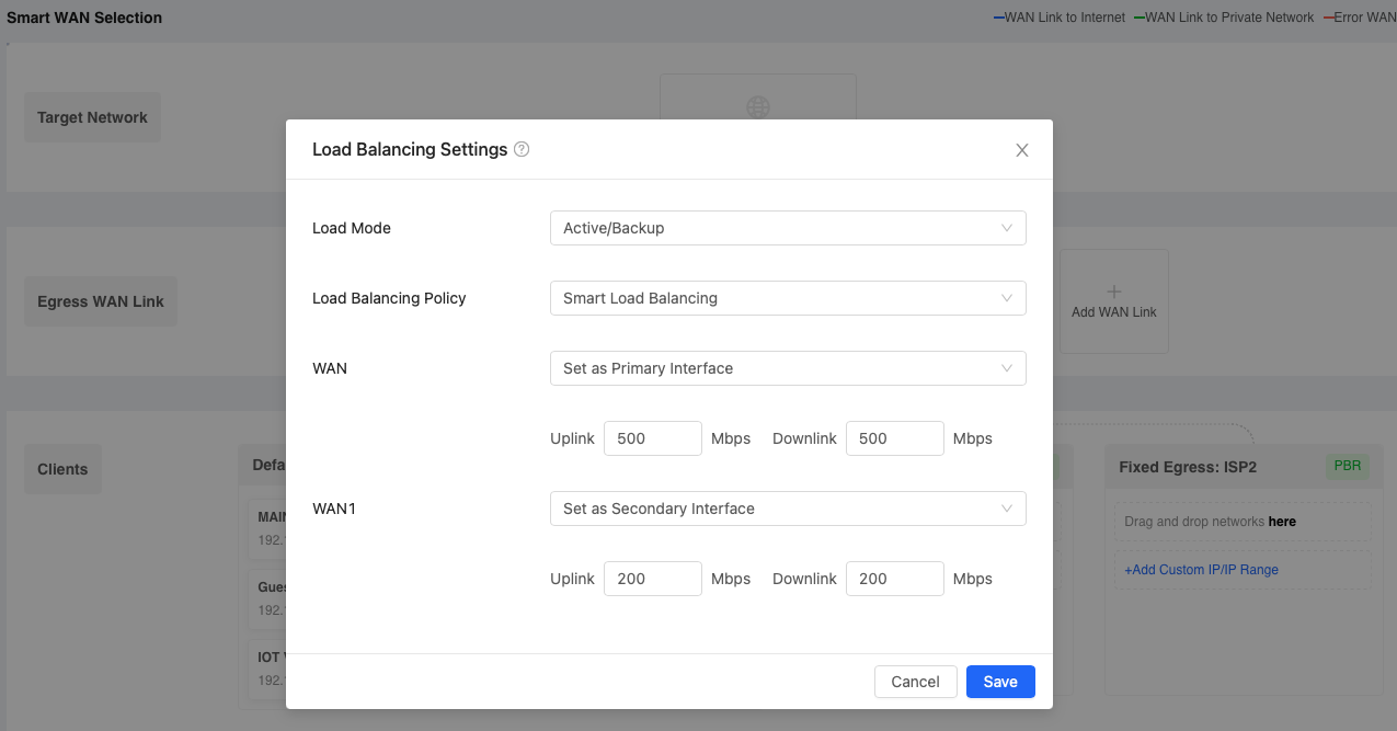

I understand that I can use the Active/Backup function, but that would mean WAN1 will only be active when WAN goes down right?
I want both WAN and WAN1 to be active simultaneously, but serve as a failover for each other if any WAN loses internet.
Is this a limitation of the device version or is there another setting I can use to achieve this?

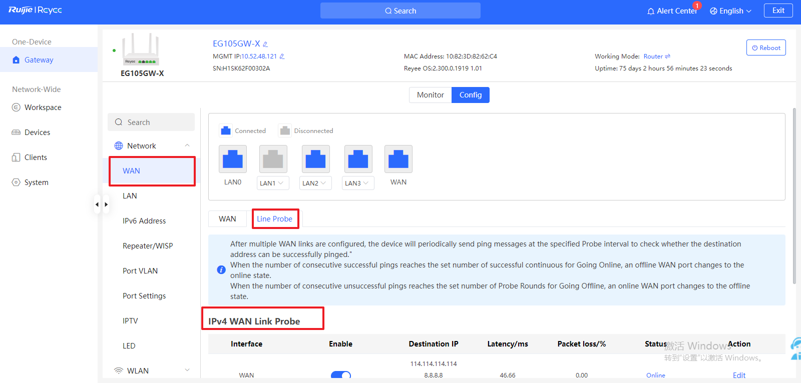

You can configure link detection on reyee gateway via the following and test whether the failover can work normally:
<img alt="图片.png">

Yes, you can check it as the following picture:

Apologies but I cannot find that function in my EG105G-P v2. I checked both the local device settings and thru cloud settings
0 2024-10-8 13:27:42 View all replies
User 29978 replied at 2024-10-8 12:35
Apologies but I cannot find that function in my EG105G-P v2. I checked both the local device setti ...
