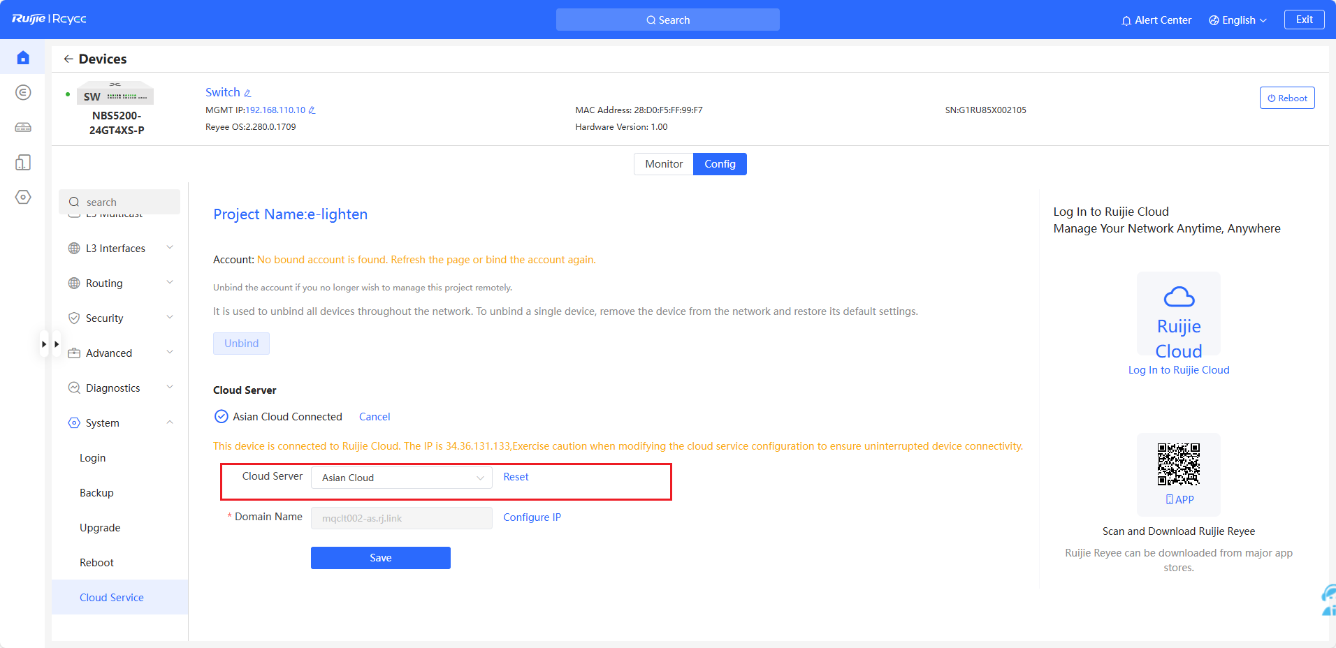

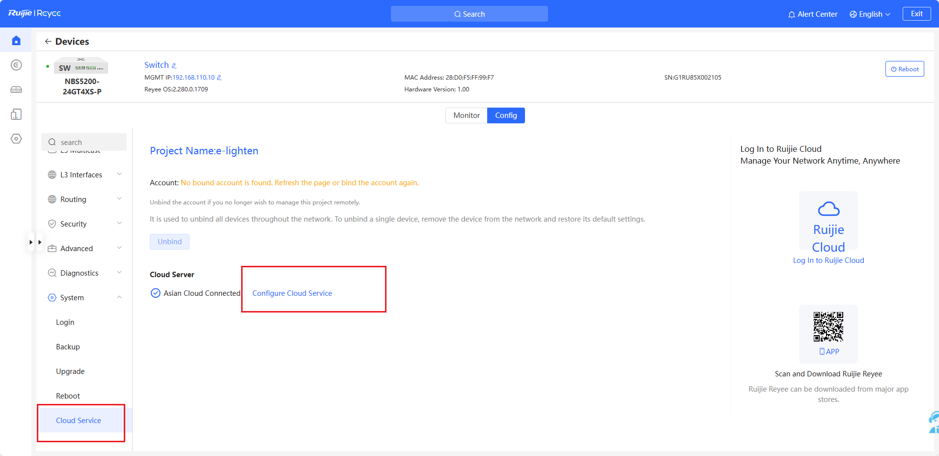

If you model is RG-NBS
[color=var(--primary5) !important]5300
-8MG2XS-UP this one , you can config the cloud service at  the eweb
Choose a different cloud server address based on your current location

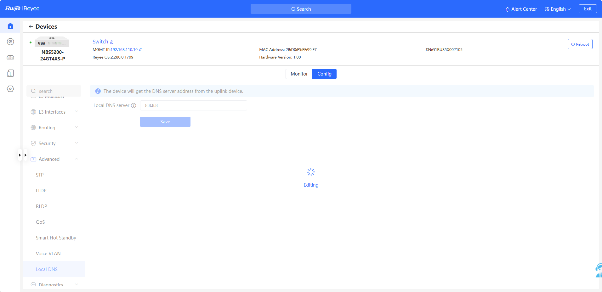

Also need set the local dns server 8.8.8.8

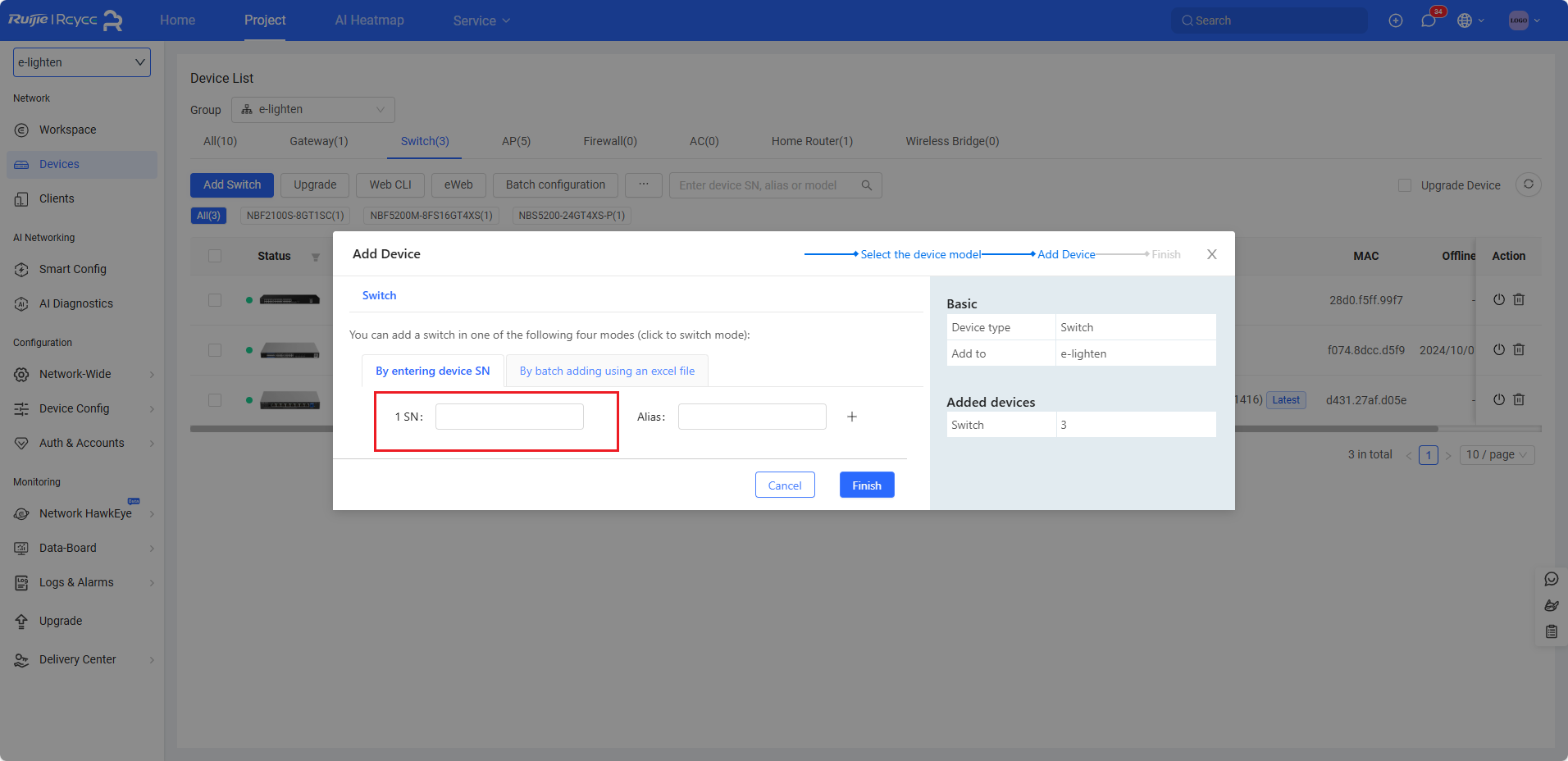

add the device SN at the cloud
