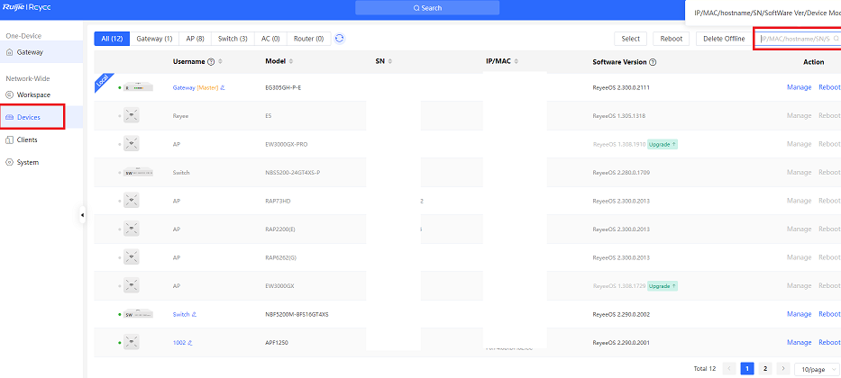

Dear customer,
If your AP is Reyee model(RAP), you can local into an AP that is still online and search the SN for the device. Then you should be able to access its web by clicking the icon of the device.
