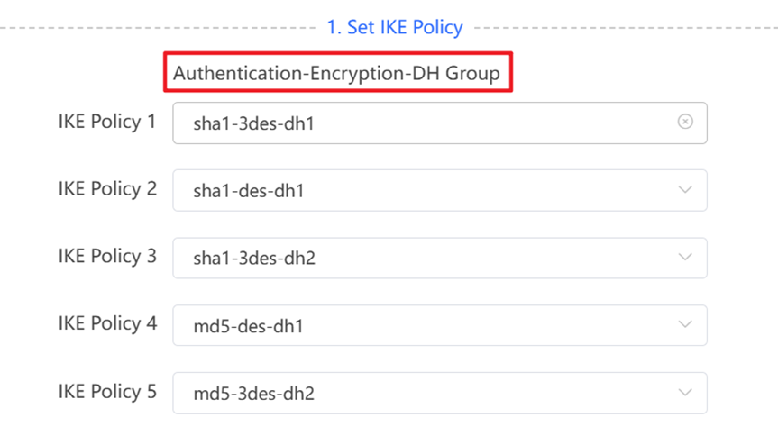

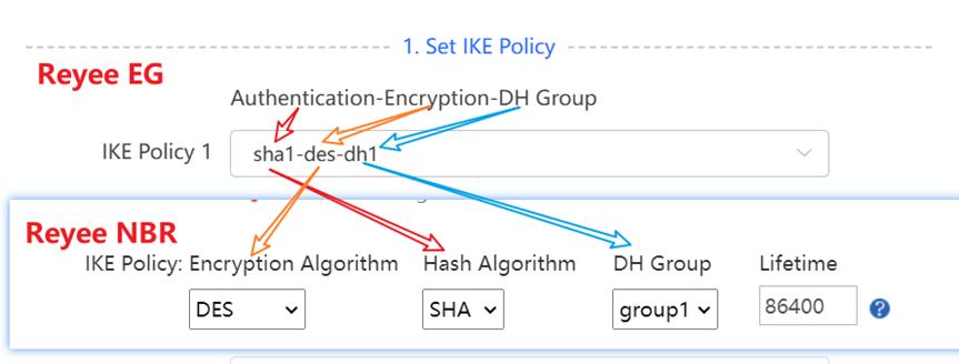

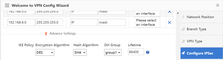

3.1 IKE Policy
Reyee EG router
Reyee NBR router
The matching relationship is shown in the following figure.
  Reyee EG router
  Authentication
  Encryption
  DH Group
  Reyee NBR router
  Hash  Algorithm
  Encryption  Algorithm
  DH Group

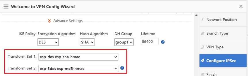

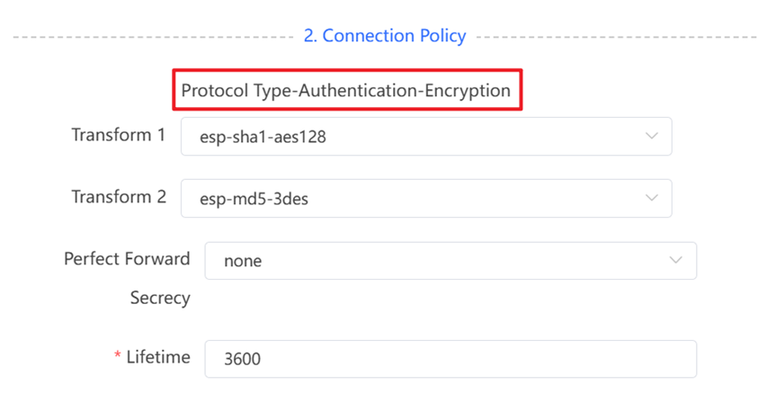

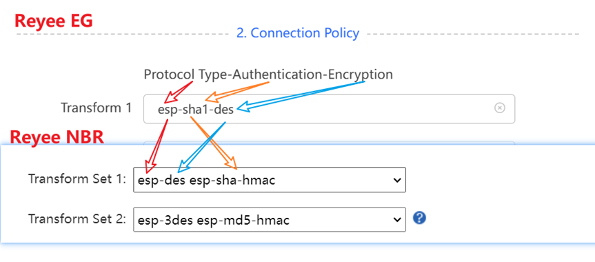

3.2 Transform Set
Reyee EG router
Reyee NBR router
  Reyee EG router
  esp-sha1-des
  Reyee EG router
  esp-des  esp-sha-hmac
