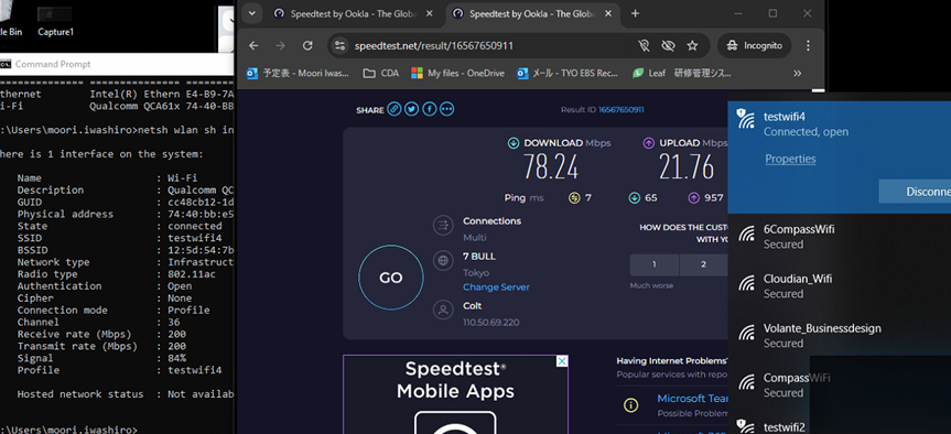

(1) The measured wireless rate and negotiated rate for clients connected to the AP840-L are low.

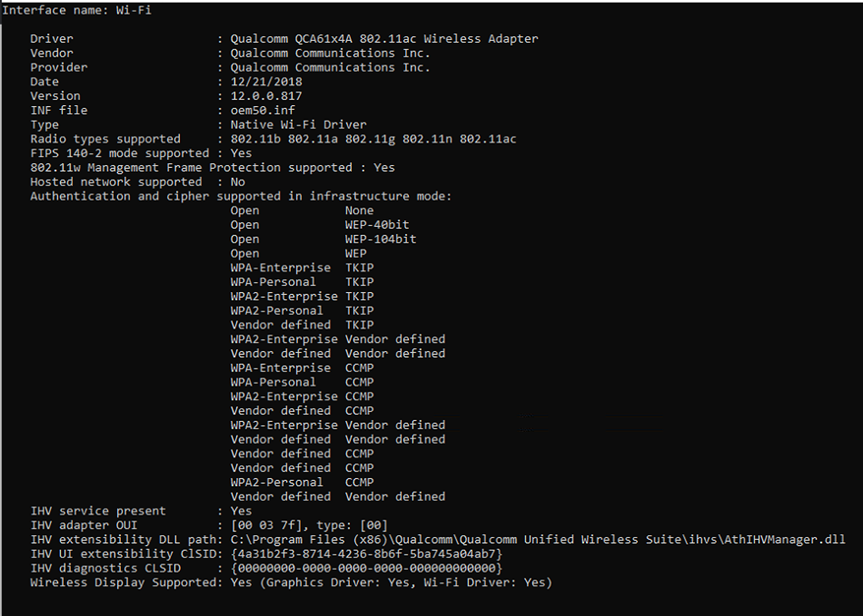

  • Check the information of abnormal wireless clients, including their MAC addresses and wireless network adapter details.Check whether the wireless network adapter can obtain a higher rate.

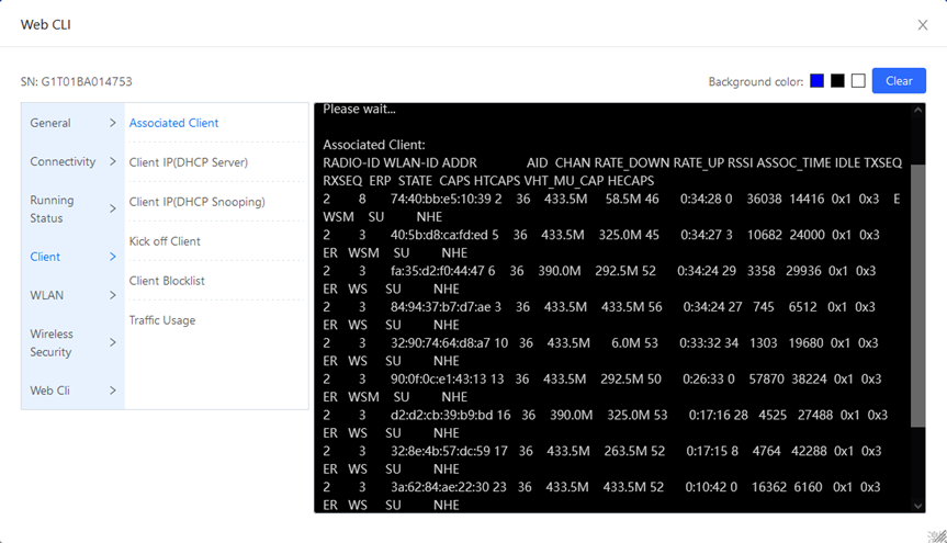

2. Check the configurations and negotiated rate on the AP associated with the abnormal wireless clients. It is found that the negotiated rate is only 433 Mbps on the 80 MHz channel.

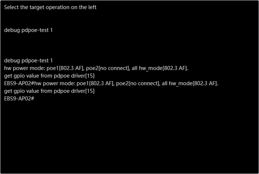

3. Check the PoE power supply. The power supply mode is set to 802.3af. When the AP operates in this mode, it can only provide a single spatial stream due to insufficient power. As a result, both the negotiated rate and the measured rate for the wireless client are low.

The Cisco switch provides power to the AP840-Lin 802.3af mode, which is insufficient. As a result, the rate measured by the wireless client is low.

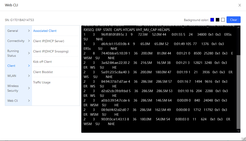

2. After Solution 2 is implemented to solve the power supply issue, the speed of wireless clients connected to the AP840-L can reach the expected value.
