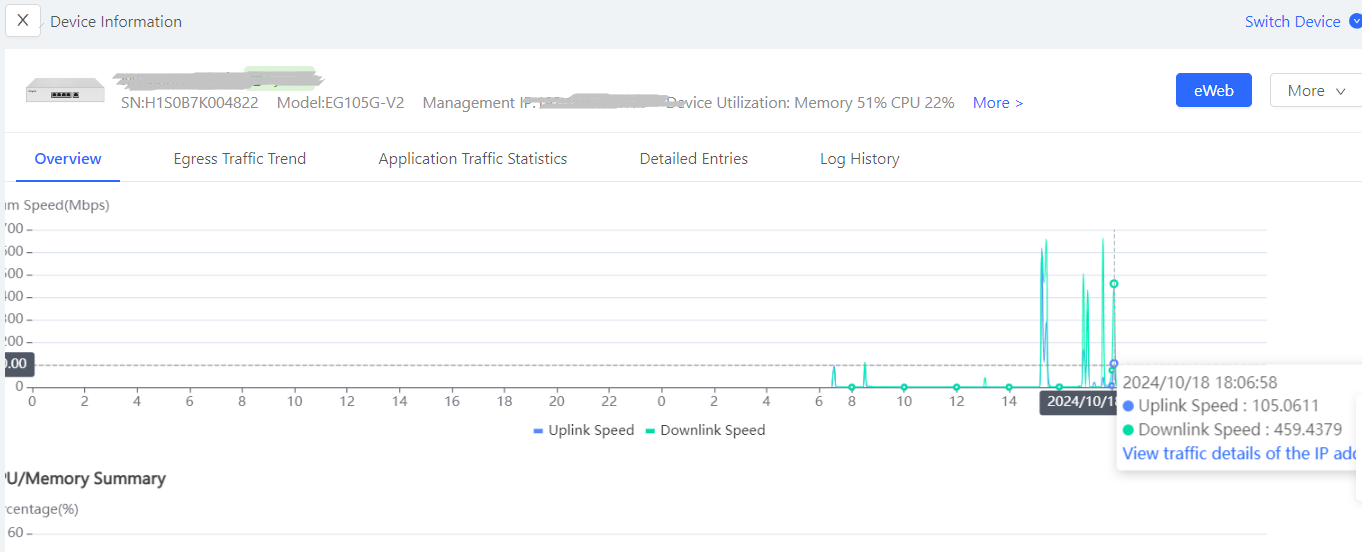

Hi just want to verify the Uplink and Downlink speed is this the throughput?
I'm using the EG Series Load Balancer.
Router Ruijie Cloud
0 2024-10-18 23:14:04 View all replies
Dear sir,
Good day.
Yes, this is the real time speed record chart of the EG.
You can use this chart to see the peak values ​​of uplink and downlink speeds at a certain moment.

So this is the whole output of the device sir. Correct?

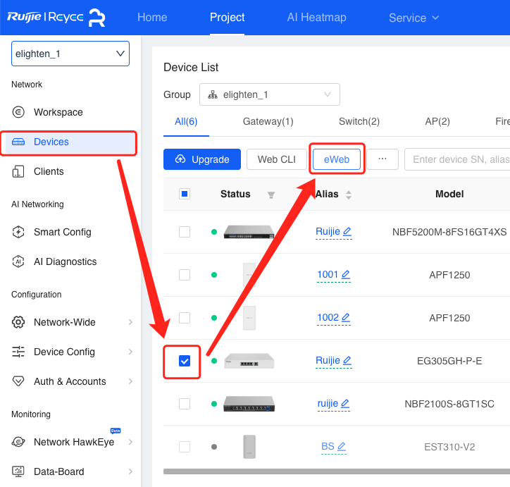

Another question sir Lex we can always monitor them but can we access the gateway remotely I mean I'd
like to reconfigure the Load Balance Settings of the gateway but I'm not in the area currently.
0 2024-10-21 10:17:04 View all replies
Jericho Penalosa replied at 2024-10-18 23:56
Another question sir Lex we can always monitor them but can we access the gateway remotely I mean I' ...
Dear Jericho,
Good day.
If your device is on Ruijie Cloud, you can try create this eWeb tunnel on the Cloud.
With the tunnel created, you can visit your device locally.

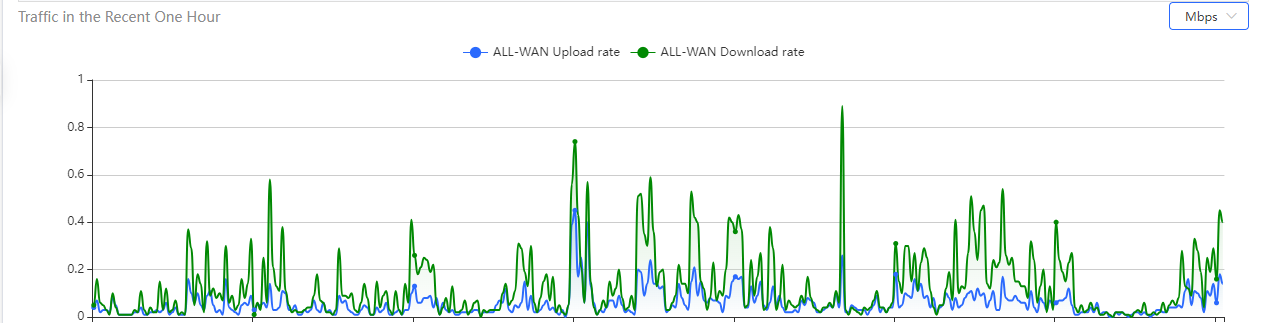

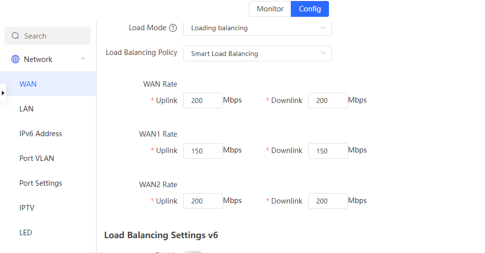

THanks Lex. Another thing sir why does my throughput max speed only shows 1 as the highest?
Below is my load balance settings:
0 2024-10-21 21:04:41 View all replies
Jericho Penalosa replied at 2024-10-21 19:34
Dear customer
Do you mean the speed limit is not in effect?
Best Regards
Tom
0 2024-10-21 22:16:41 View all replies
GTAC-Tom replied at 2024-10-21 21:04
Dear customer
Yes kinda because for other devices it shows 300mbps to 500mbps
0 2024-10-22 09:28:36 View all replies
Jericho Penalosa replied at 2024-10-21 22:16
Dear Penalosa,
It could be that there was not much traffic moved through the WAN ports when you monitored it. You can run a speed test(https://www.speedtest.net/
) on a device connected to the EG and check if the traffic spikes.
