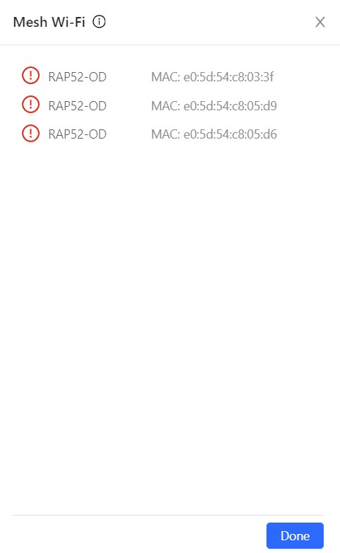

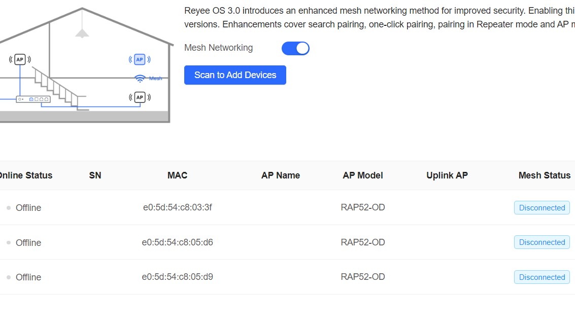

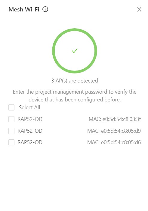

Good day, i have 4 x RAP52 OD units. I have created a project and successfully added my main unit, after scanning for new devices the other 3 come up. After clicking on the pairing i get red explanation marks on all 3 then it shows them as disconnected. i would greatly appreciate help as my client is about to go crazy

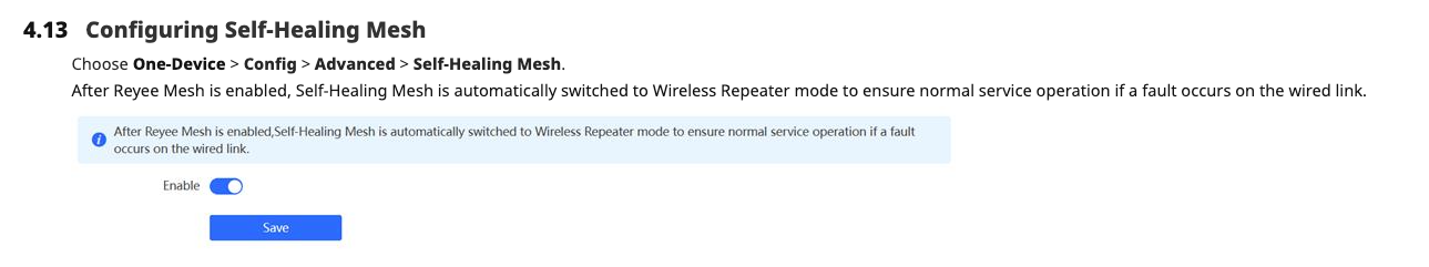

If the device has been successfully meshed before, you can try the Self-Healing Mesh function and the system will automatically repair the Mesh network.
