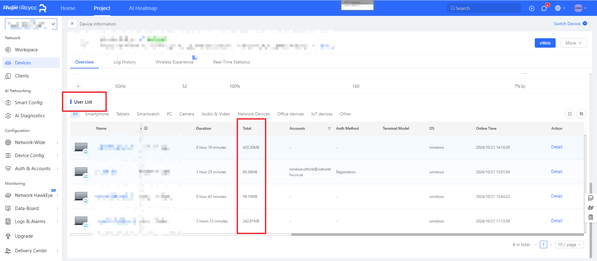

Hello,
When you access the dveice list, then you can click device SN.
Find user list then you will see this:
Micca

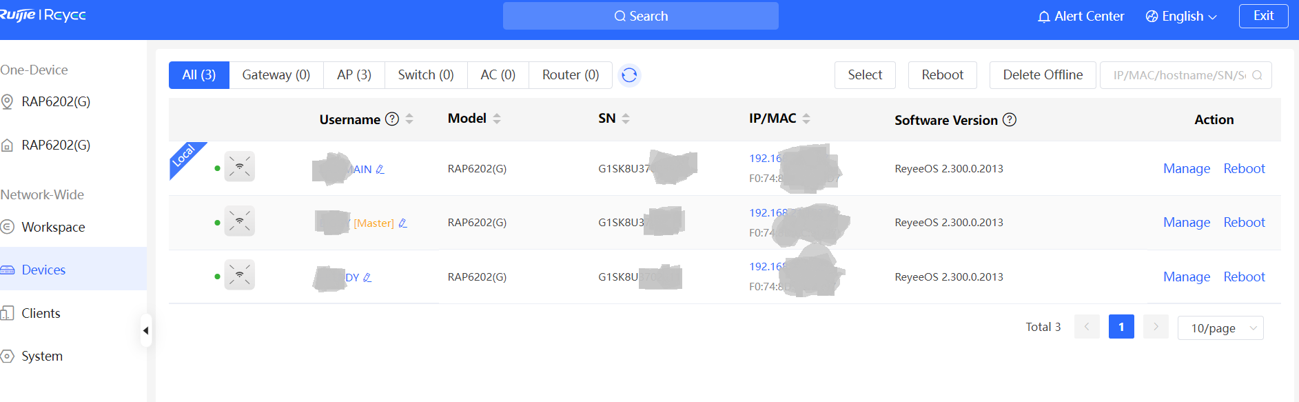

When I press the device list, the serial number has no option for pressing
0 2024-10-21 21:48:41 View all replies
LAMENT MABASA replied at 2024-10-21 21:21
On the device eweb, you can click Clients to check the client detailed connected information.
