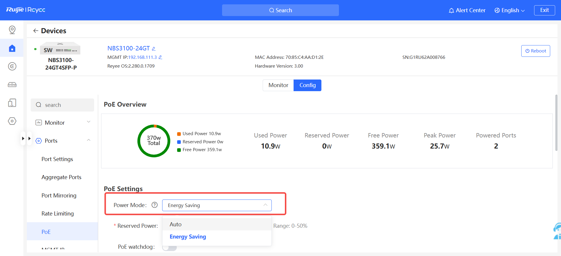

Hi Team, i need to trun off energy efficient mode on a POE Switch - Model NBS3100-24GT4SFP-P
can you please help
RG-NBS3100-24GT4SFP-P
Switch
0 2024-10-22 12:19:33 View all replies
Edited by GTAC-Char at 2024-10-28 14:59
Hello!

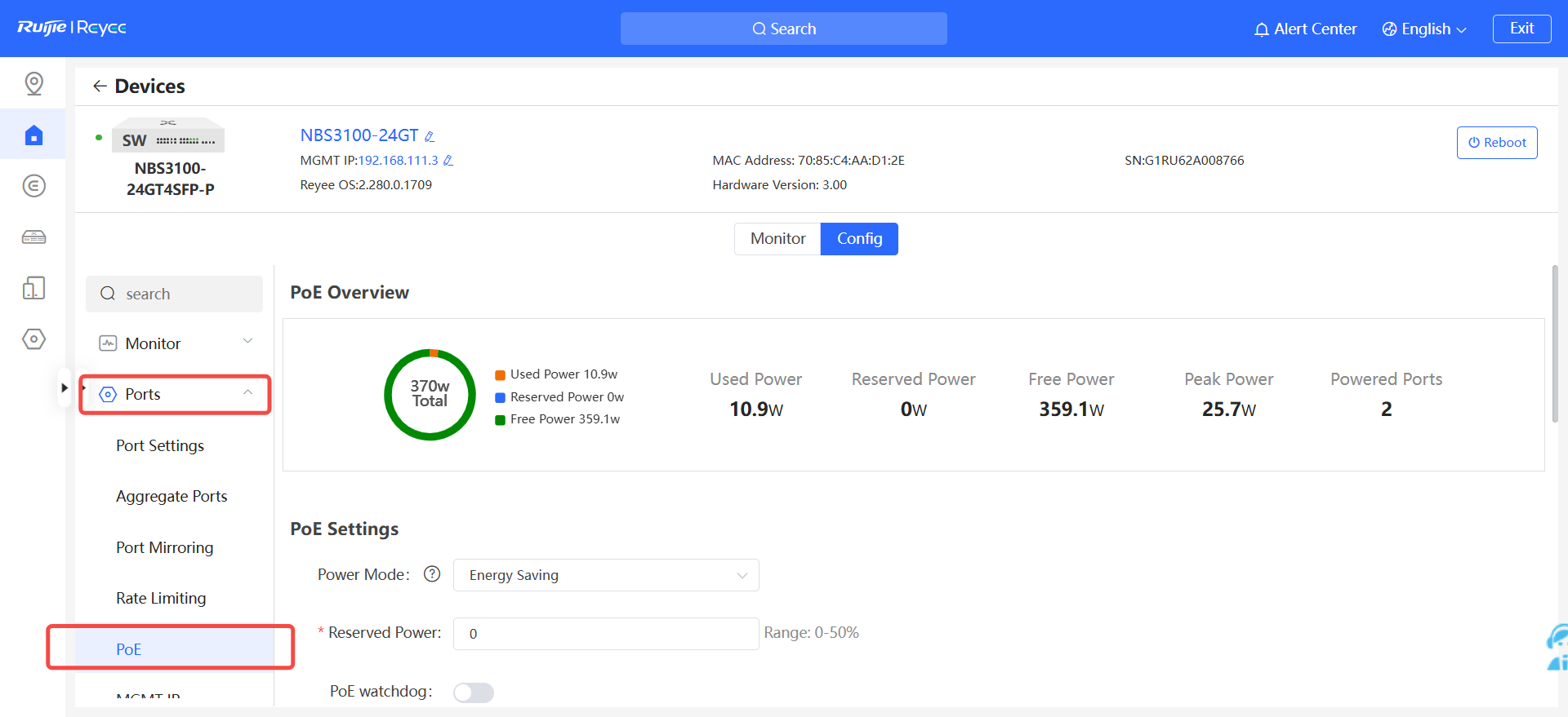

1.we can go to eweb first,and then find the “Port”
2.And here you can change your power mode
