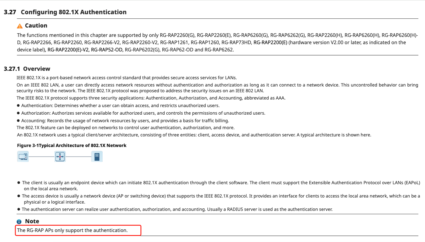

Dear Sir,
Could you show me what the configuration of your project? You can send the shared link to my email: ************@ruijie.com.cn
And here's the configuration guide of 802.1X on RAP2260(G), you may check it first.
https://reyee.ruijie.com/en-global/support/documents/slide_rg-rap-series-reyeeos-2-300-configuration-guide/#_Toc176278835

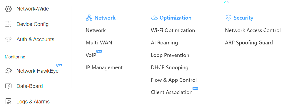

Hi Lex,
Here's what I only see when I clicked Network Wide in Ruijie Cloud.
I also sent you an email regarding on the screenshot.
