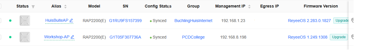

Hello Reyee
Reyee RG-RAP2200(E) firmware not updating. I have restarted Access Points
RG-RAP2200(E)
Firmware Troubleshooting Wireless
0 2024-10-23 20:31:46 Solved View all replies
Dear sir,
Are you trying to upgrade the firmware of the Reyee RG-RAP2200(E)?
If you're facing problem when upgrading the firmware, you may try upload the firmware file on AP eWeb locally.
And if the current firmware version is ReyeeOS 1.249.1308, it might be too old to upgrade to the latest one at one time.
Here's the transitional version for you to upgrade, you can upgrade to ReyeeOS248 first, then upgrade to the latest version
ReyeeOS300 next. (Click the version No. to download)

I got same problem even by trying eWeb update

Yes I cant do firmware upgrade on both RG-RAP2200(E)
0 2024-10-23 21:44:51 View all replies
I have downloaded RG-RAP2200(E) ReyeeOS248 firmware and manually uploaded. Firmware up to date
