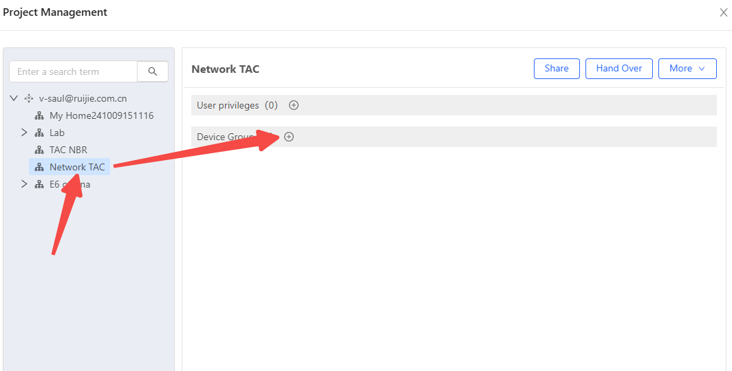

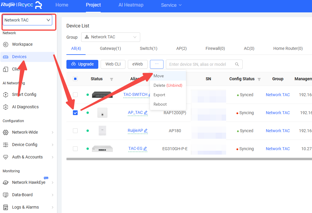

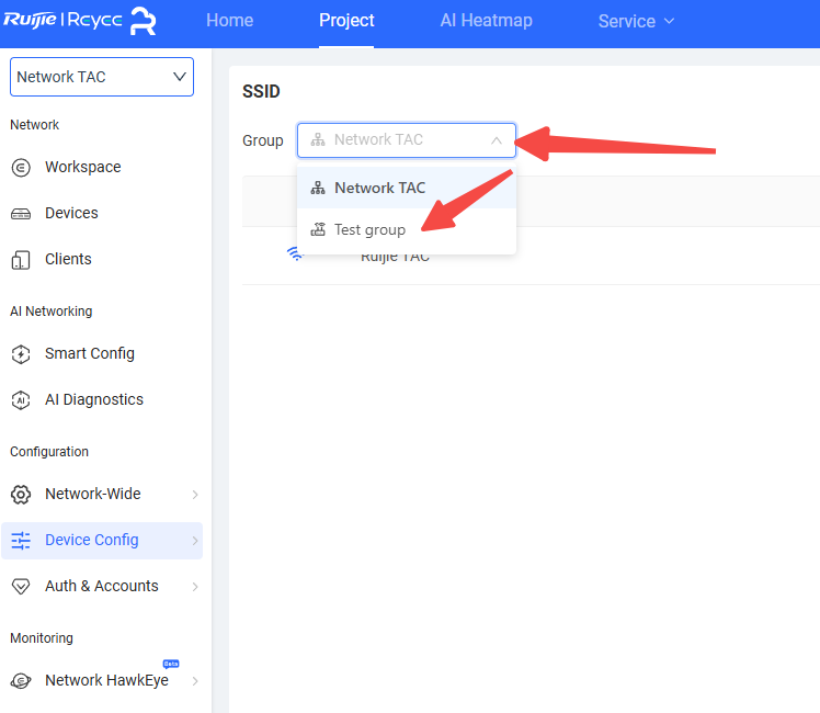

To create a device group you can do it as follows:
When you create the ssid, be sure to select the correct group

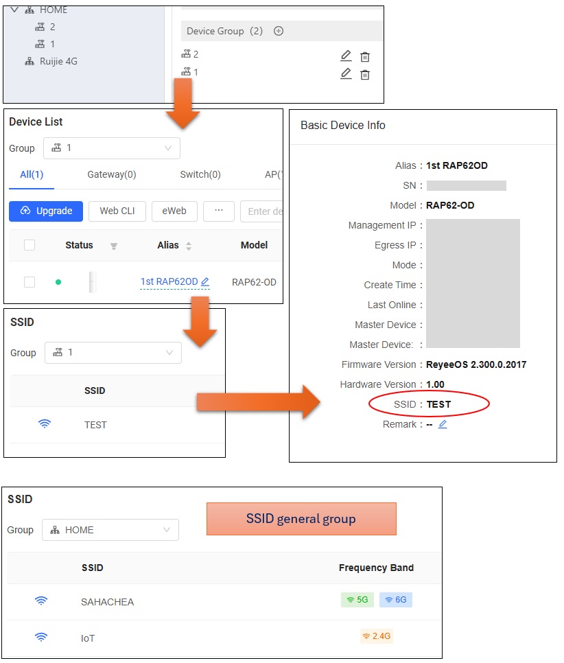

I have implemented the settings as per your instructions. Specifically, I moved RAP62OD to Group 1 and created the SSID "TEST." Upon reviewing the access point details, I observed that it is only broadcasting the "TEST" SSID, without broadcasting the general group SSID.
Could you please confirm if I may have made an error in the configuration?
