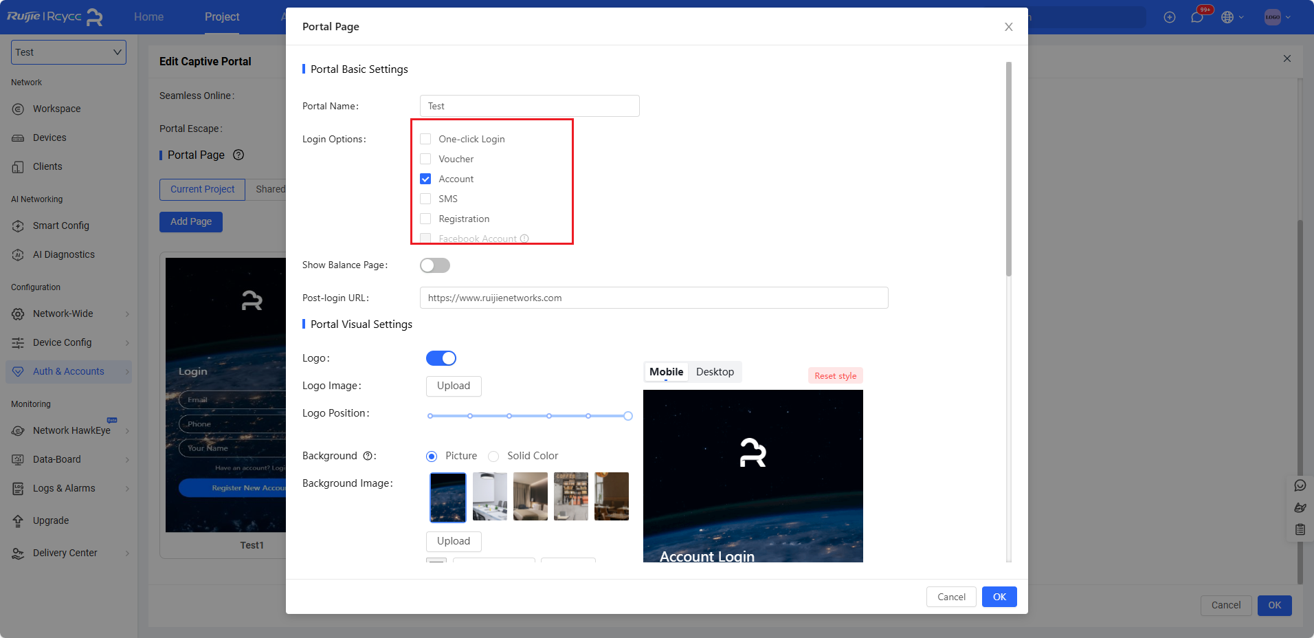

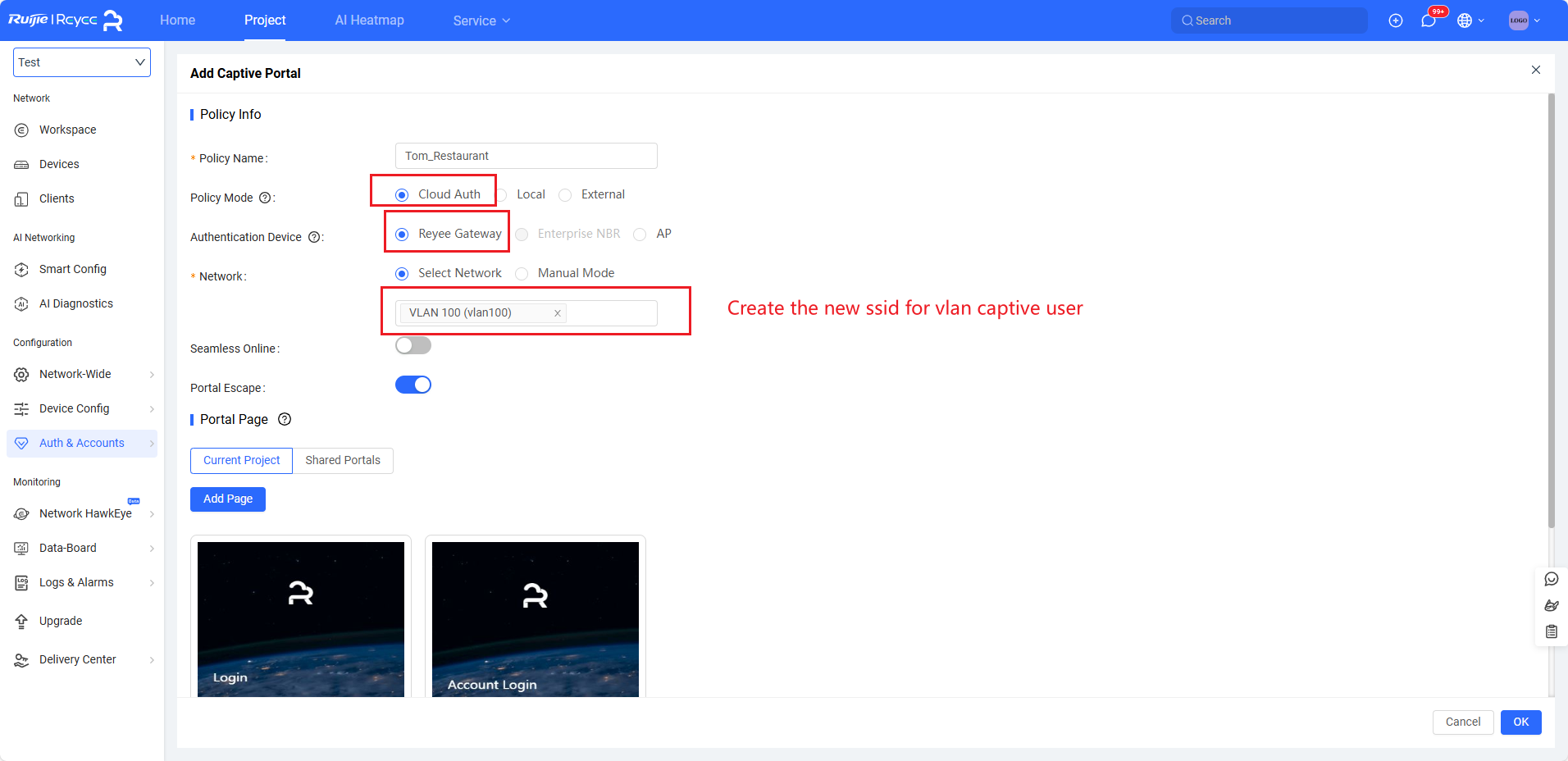

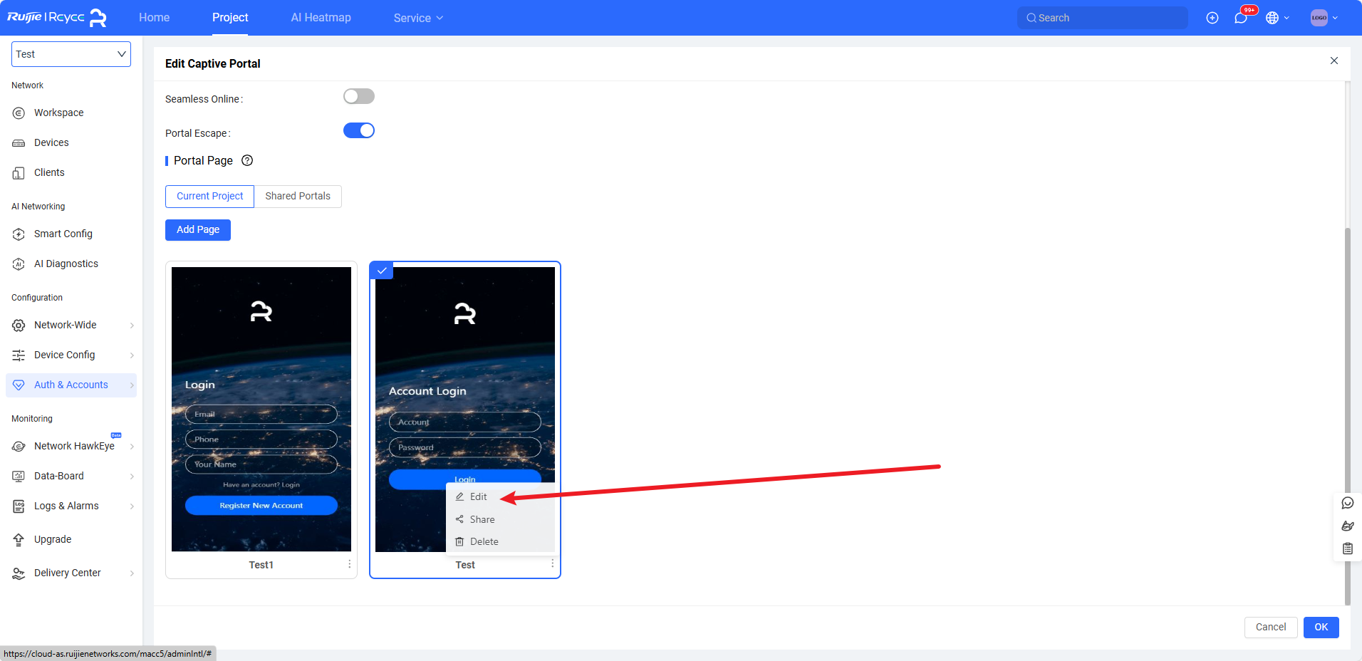

Dear customer

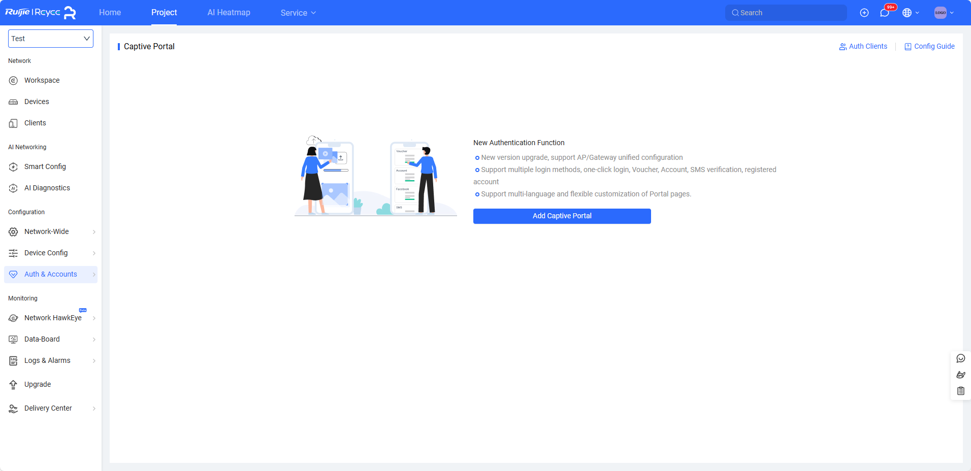

For our EG device and AP you can follow this guide to config the SSID and captive portal

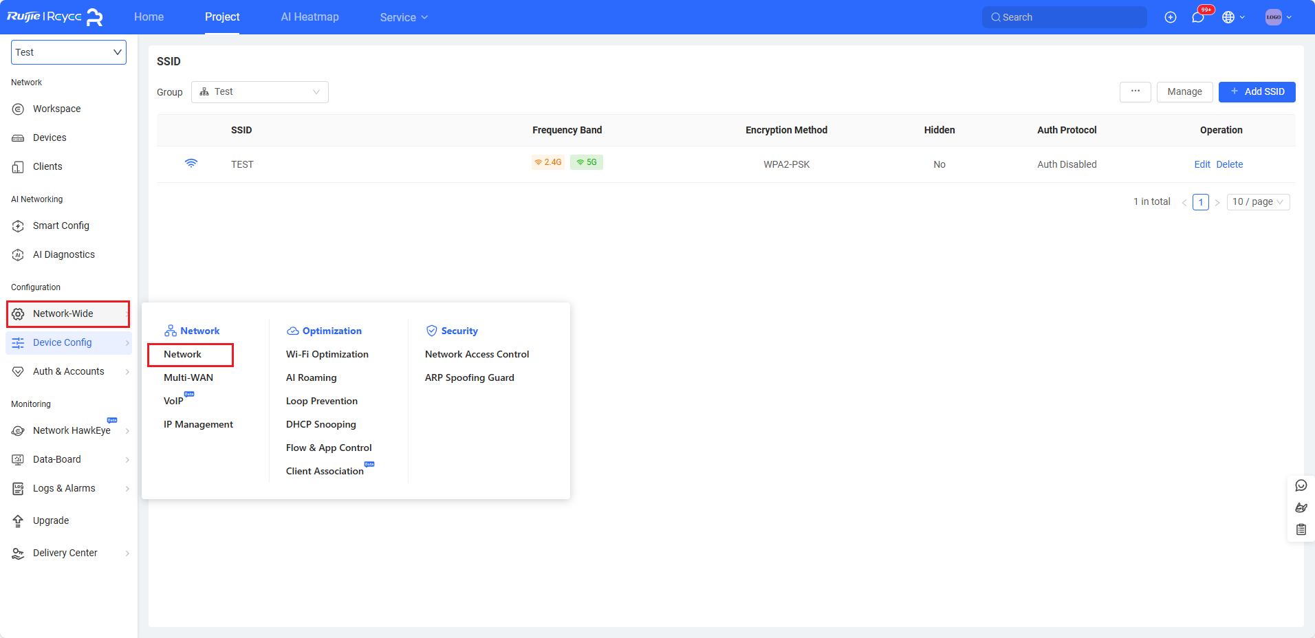

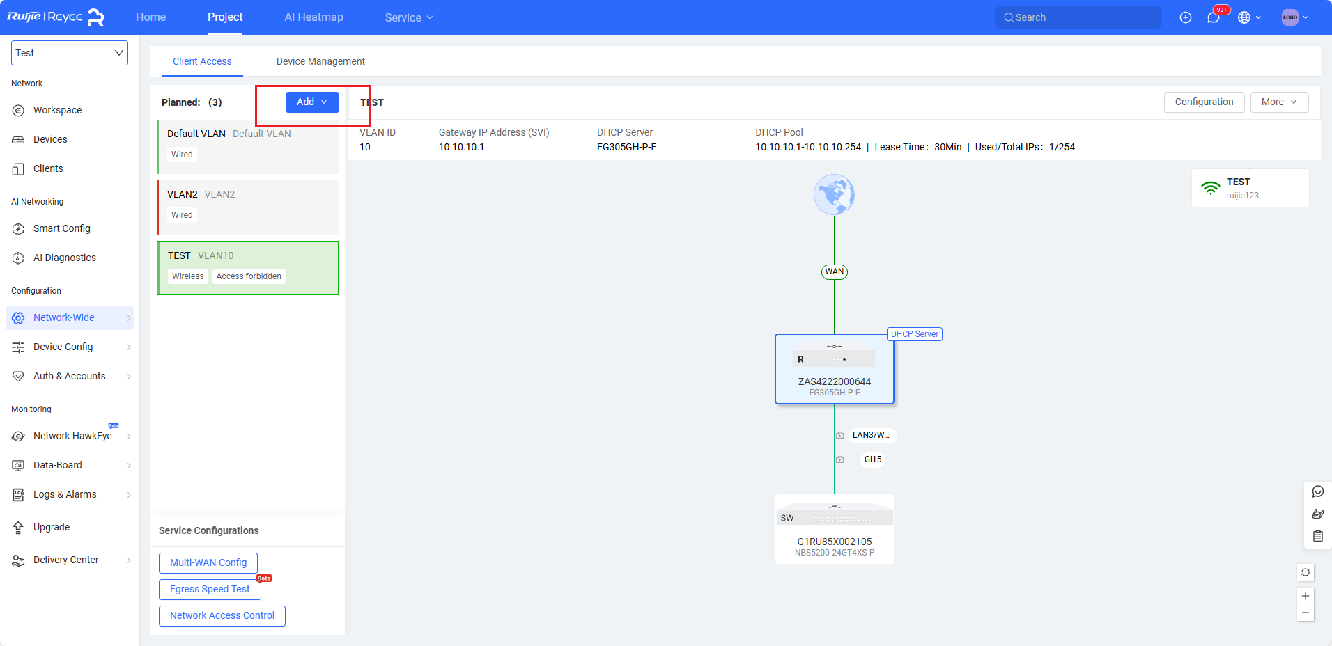

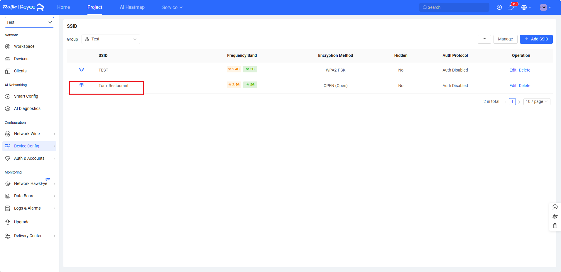

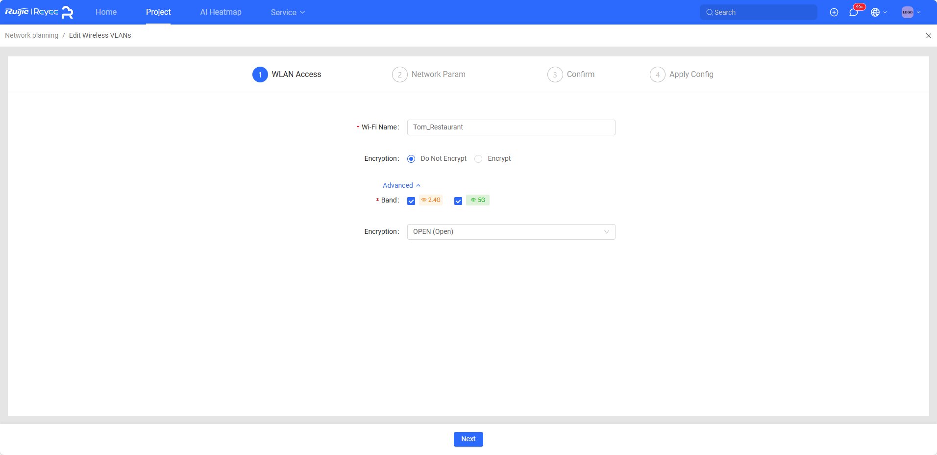

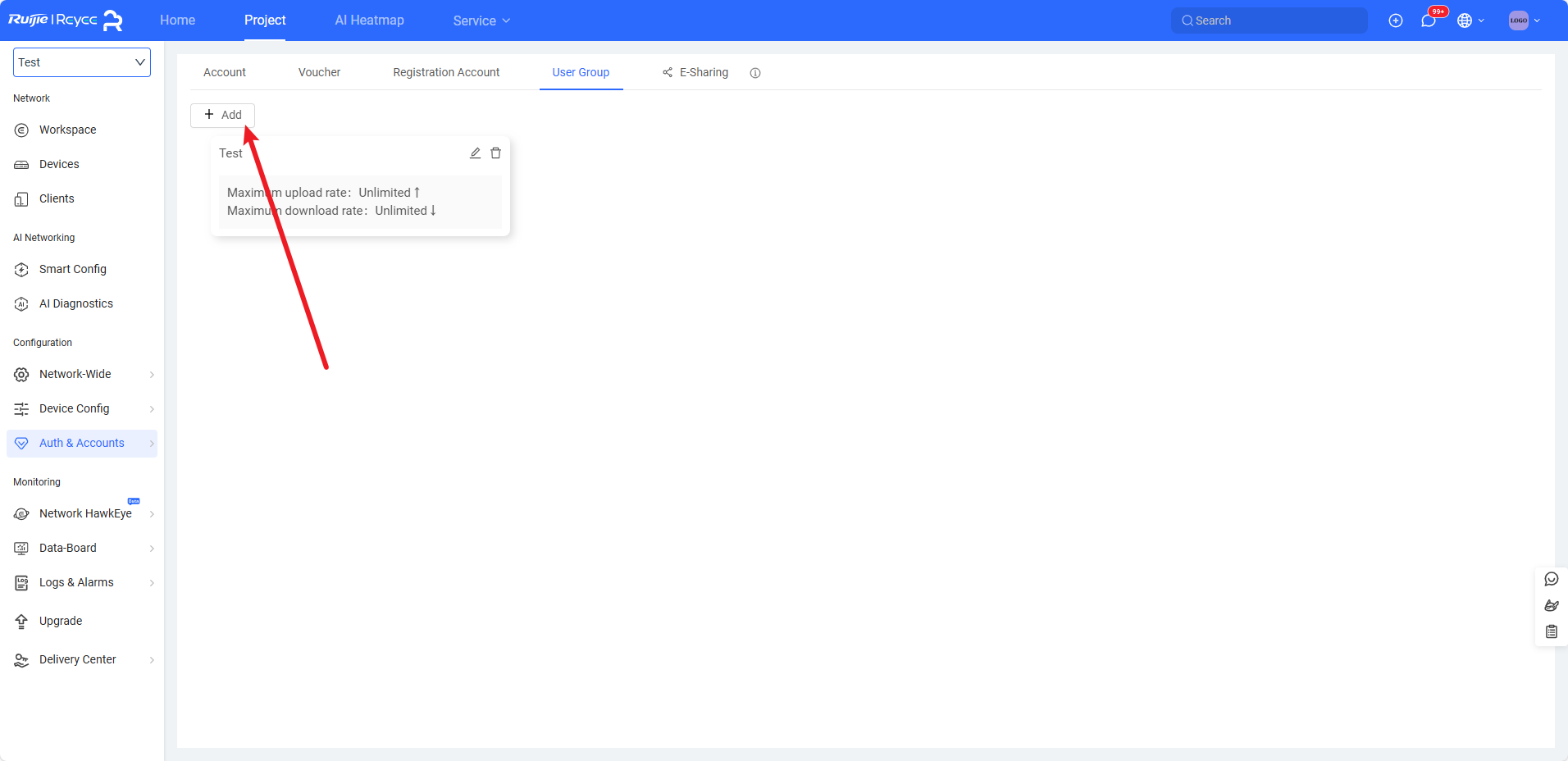

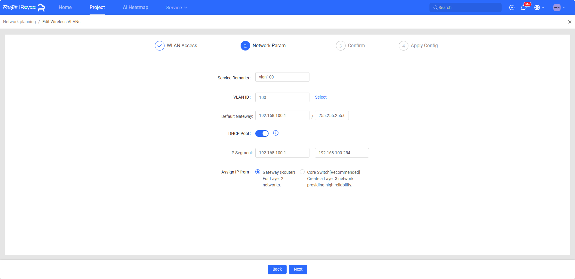

1.Create a new vlan id and new SSID for the captive portal user

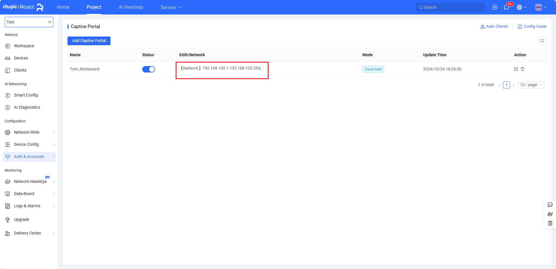

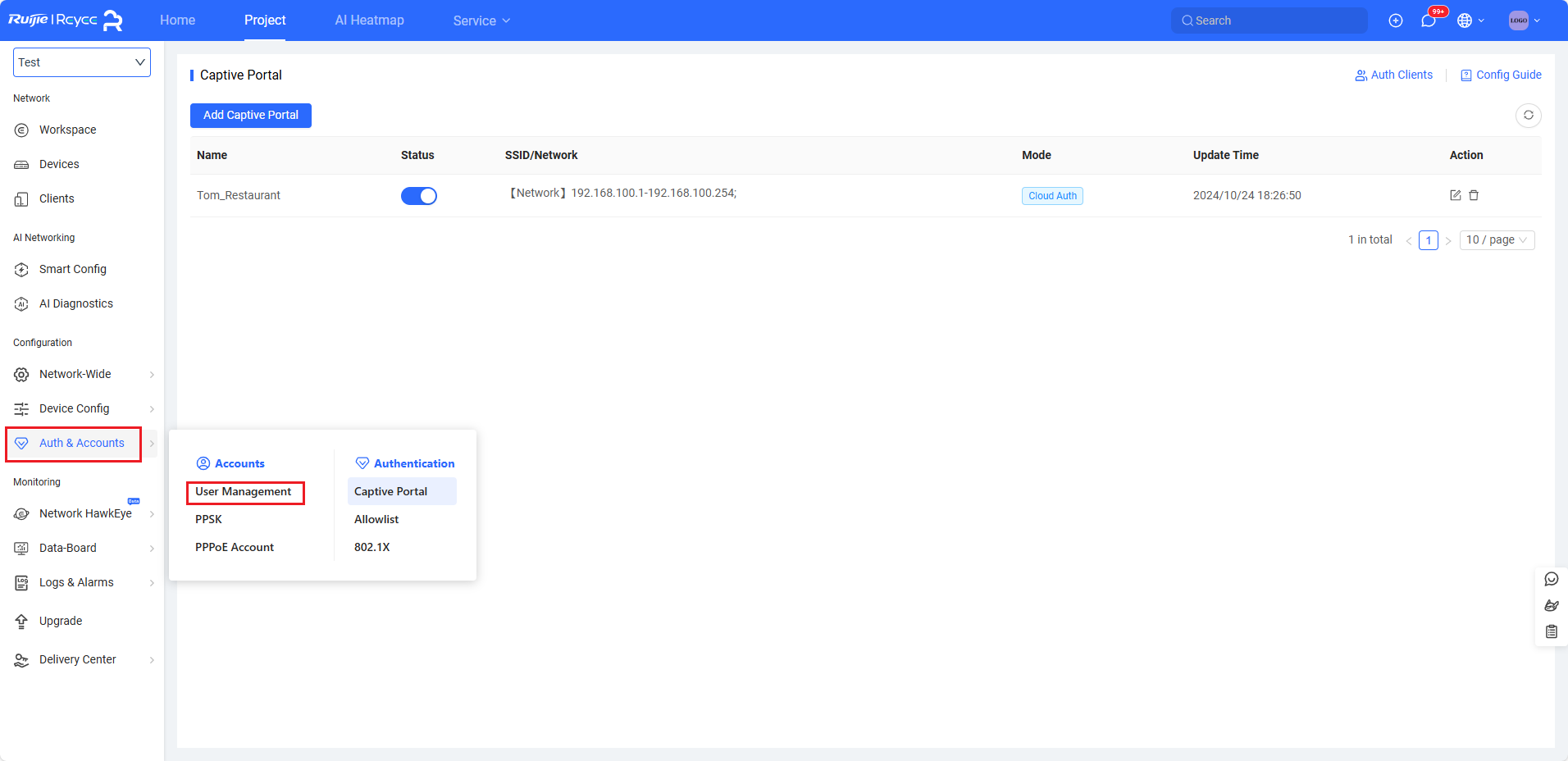

2. create captive portal policy bind this SSID and ip segment

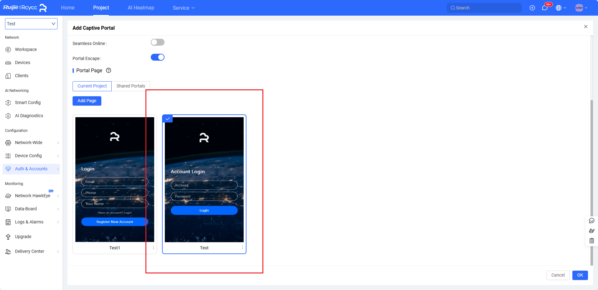

3. For the auth method you can set at the captive portal page

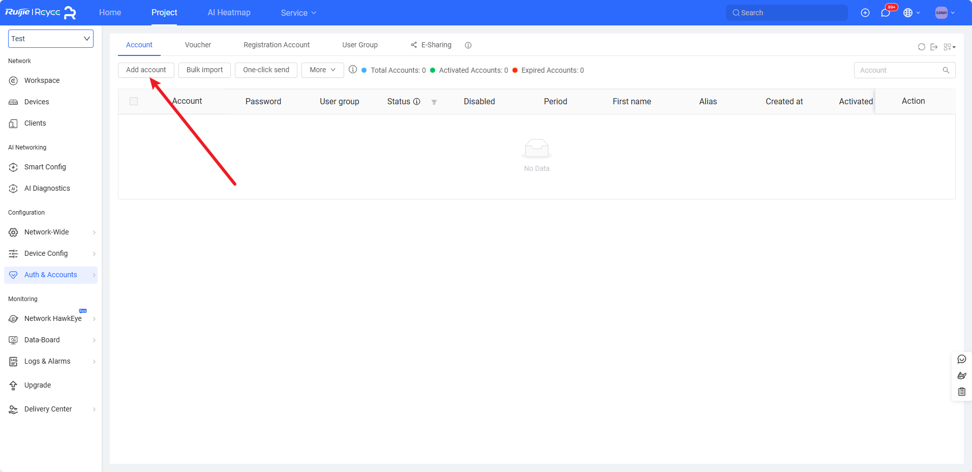

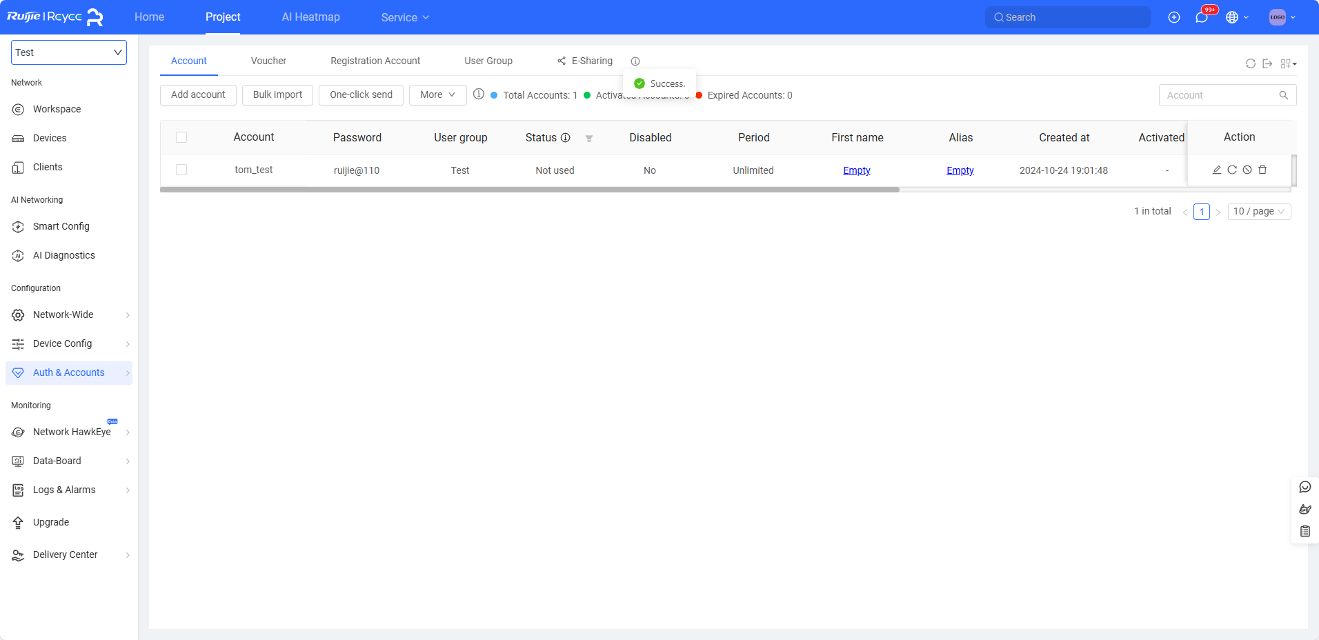

4.Create the auth account

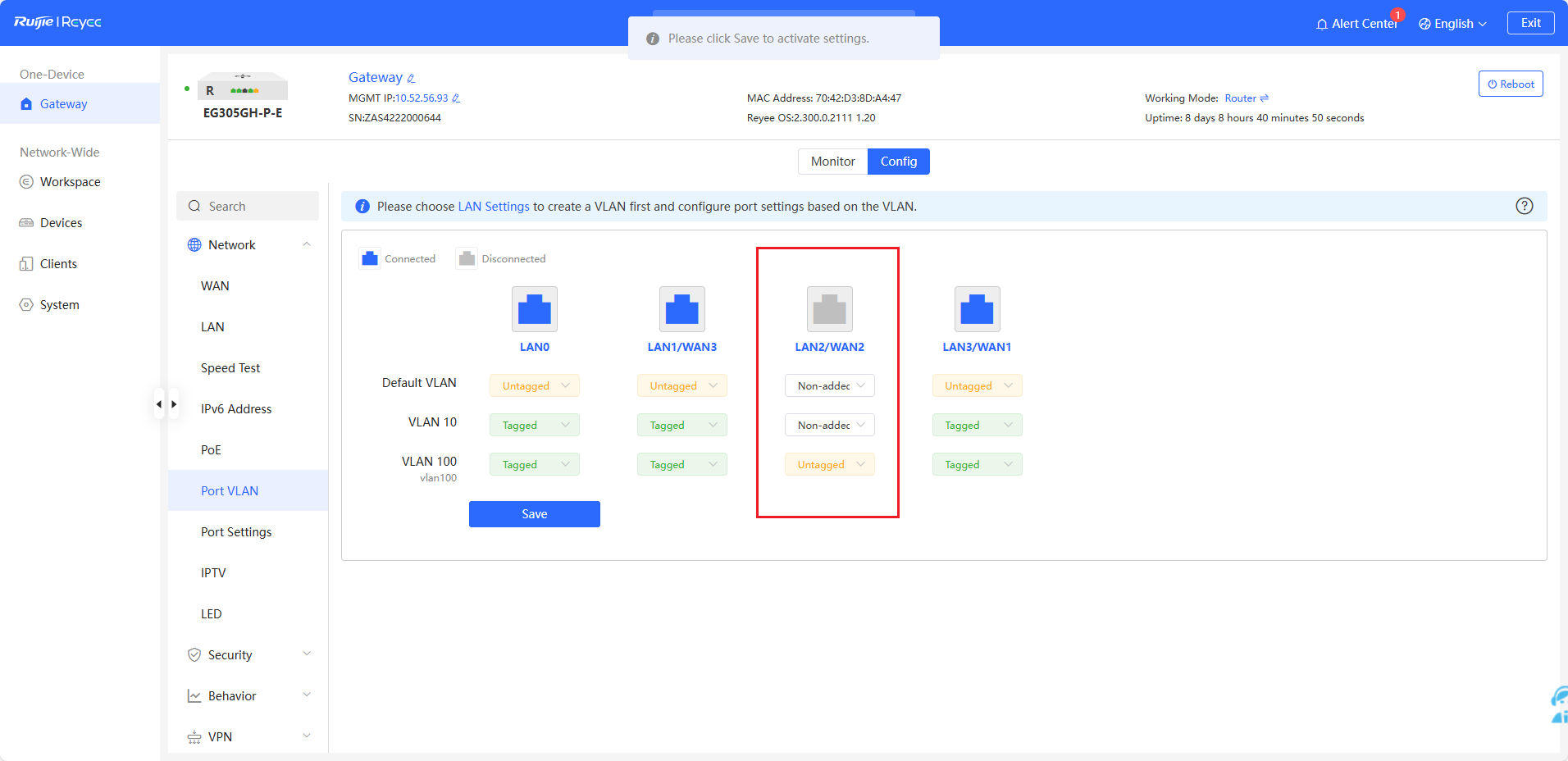

5. For third AP device , you can collect to the Lan port and config the vlan id link this one

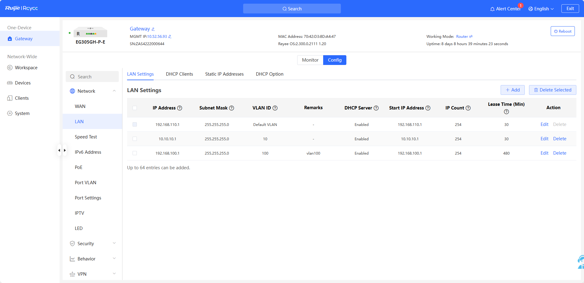

Confirm the vlan 100 and gateway have configed at the EG device
At the port connect to Third AP, you can config the port follow this one. Only permit vlan 100. If yoy want permit more vlan id you can change the config keep same with another port.
If the Third-part AP user can get vlan 100 192.168.100.x/24 ip address, will use the captive portal auth.
