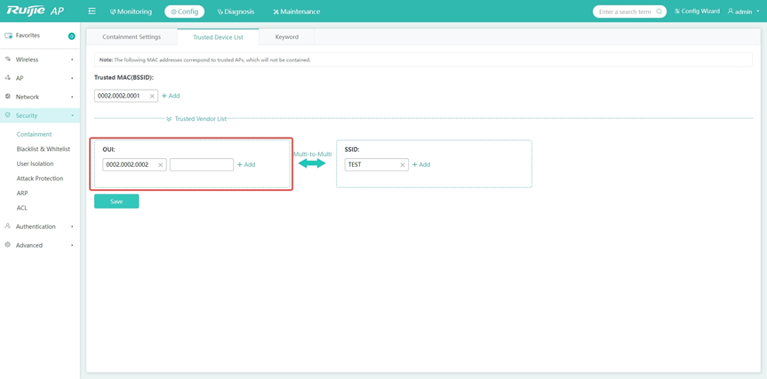

  • Rogue APs may exist in a WLAN. Rogue APs may have security vulnerabilities and can be manipulated by attackers to seriously threaten and endanger network security. The containment function can be enabled on the AP to attack rogue devices and prevent other wireless STAs from being associated with rogue devices.
  • When the rogue AP containment function is enabled, the APs not authorized will be contained. However, some APS are trusted devices and special processing is required. You can configure the MAC addresses of trusted devices
  • By configuring the OUI, AP is able to add the products manufactured by the OUI company into the whitelist and not to block them. For example, if you configure the OUI like this, the OUI '0002.00' would be recorded by the AP.
