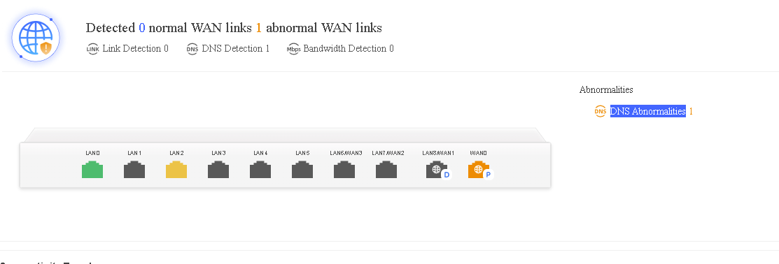

WAN links 1 abnormal WAN links ..how to solve? Reply
Mohd Rafi
2803 2 2024-10-25 10:17:09
Edited by Mohd Rafi at 2024-10-25 10:21
Router Ruijie Cloud
0 2024-10-25 13:11:15 View all replies
Hi Mohd Rafi,
I'm sorry that we can't provide a specific solution for you based on current information. Can you help to check the following aspects:
1. Check current DNS server on the WAN port.  If it's not 8.8.8.8, please try to configure 8.8.8.8 on the WAN port
2. Check if you can ping the current DNS server on the WAN port. If it's you can ping the DNS server on the device,it could be the ISP link unstable, need to confirm with ISP side
If the issue still exists. I would be glad to help you in Community.
Micca
