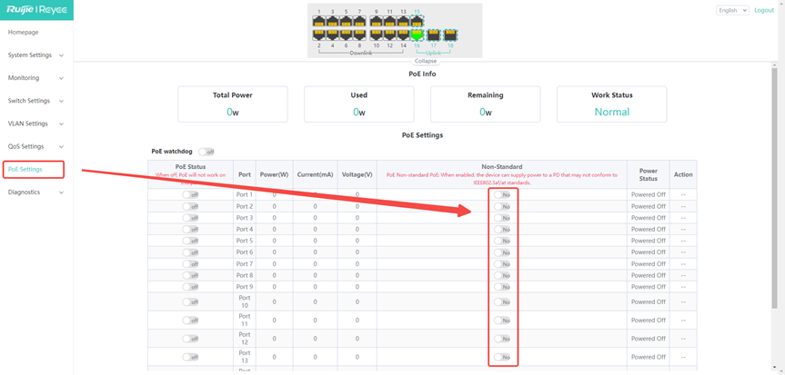

How to enable non-standard PoE on Reyee ES200 Series switches? Reply
2849 1 2024-10-25 17:41:11
Non-standard PoE: When enabled, the device can supply power to a PD that may not conform to IEEE802.3af/at standards.
RG-ES210GC-LP
Switch
0 2024-10-26 02:52:05 View all replies
Hi Sophia!
Thanks for that!
So, i will can connect a device that needs 48V to power on, sure?
