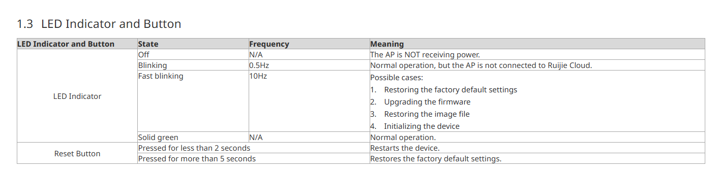

https://reyee.ruijie.com/en-global/support/documents/slide_ruijie-reyee-rg-rap2200-f-access-point-hardware-installation-and-reference-guide-en/

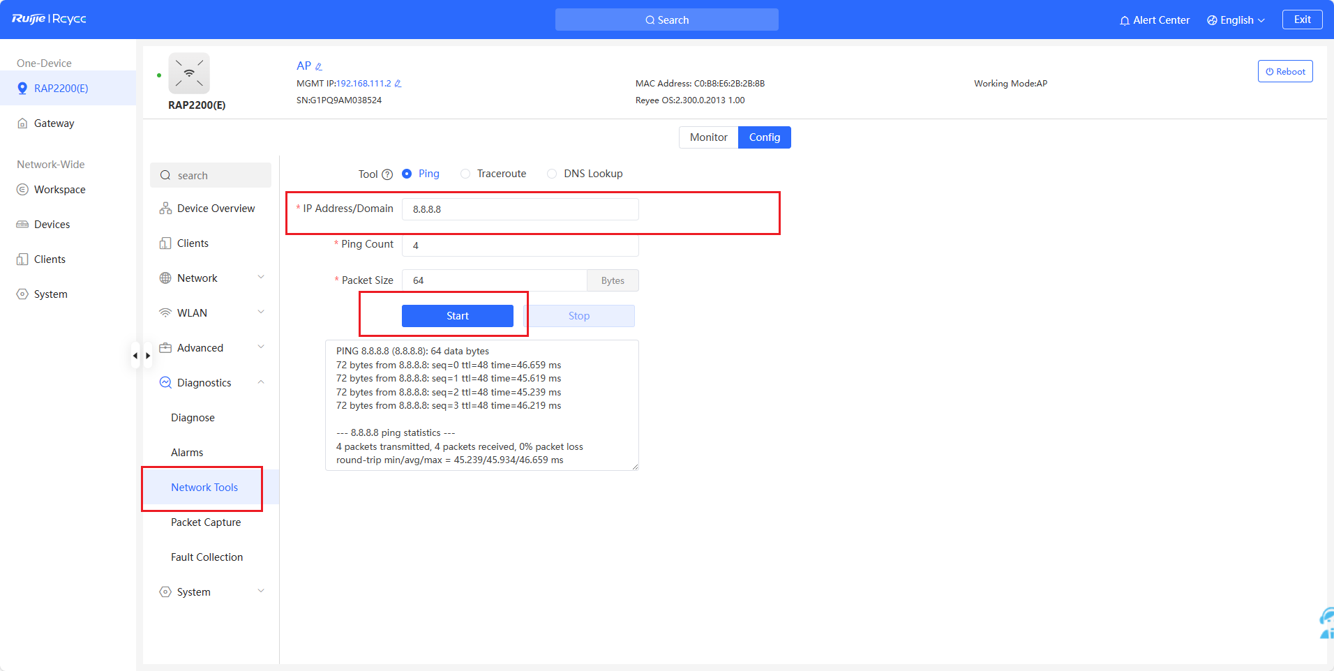

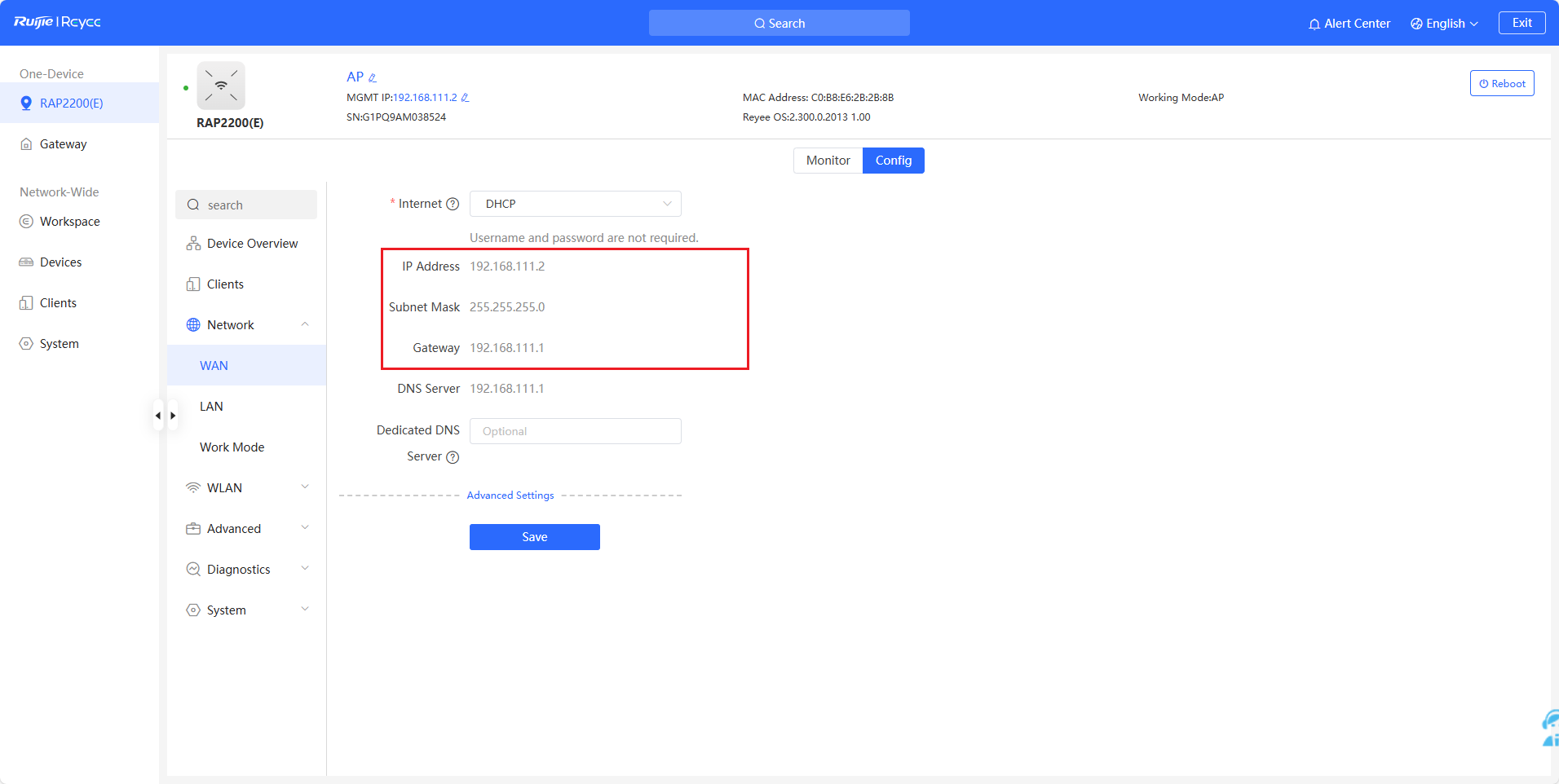

According to your description, you are not currently connected to Ruijie cloud.Can the current AP obtain an IP address and access the network normally?
And test if you can ping 8.8.8.8 and check the cloud service config
