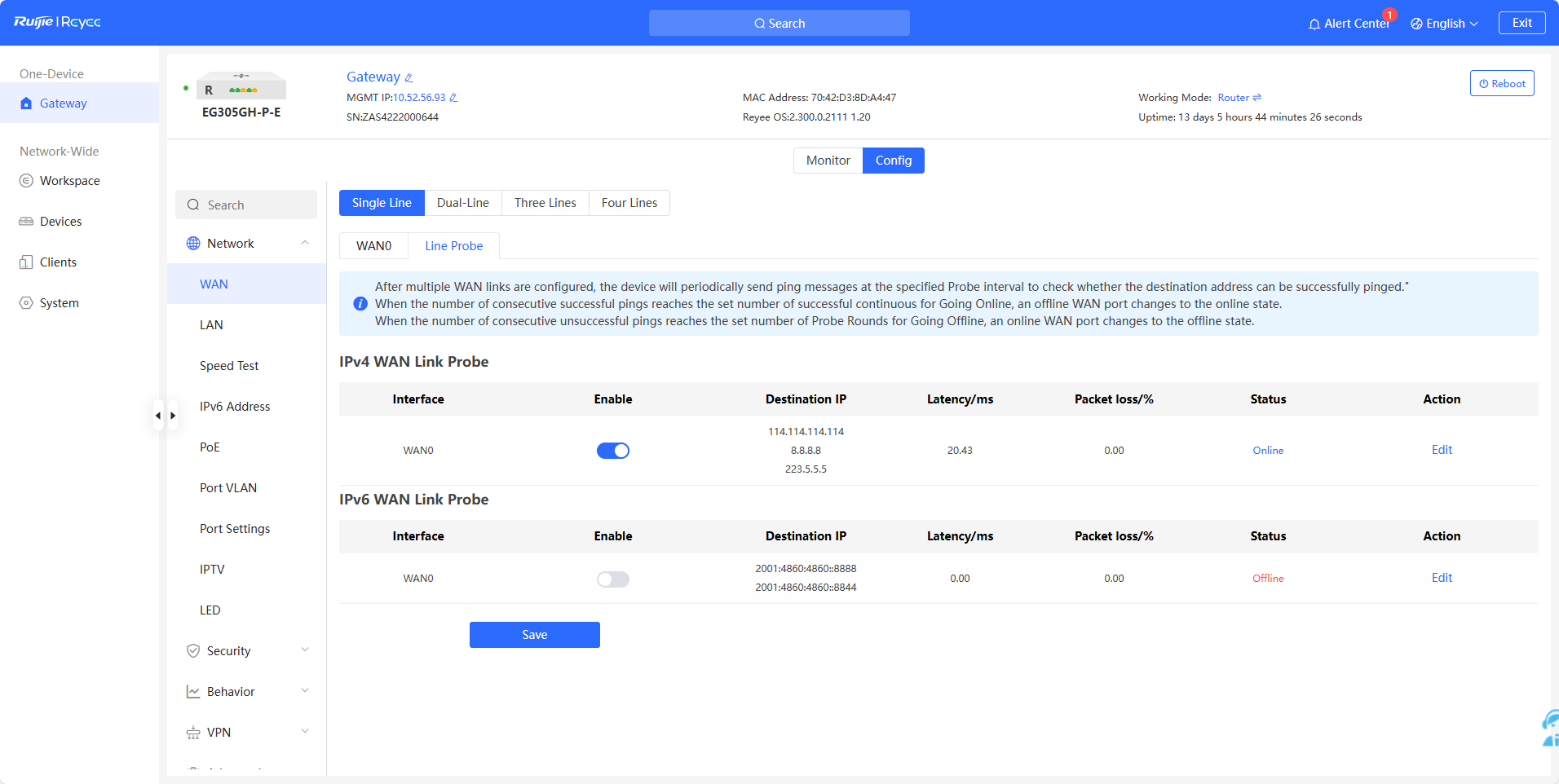

Dear Support,
In the case of 2 WANs, EG has Smart Load Balancing. If WAN 1 is down by this down from the ISP, how will the EG switch to use WAN 2? Because it is not down from our internal network, the destination device is still attached to the DHCP of WAN1?
Thank you and Best Regard.
RG-EG105G V2
Troubleshooting Technical Introduction Learning material Smart Load Balancing Router
0 2024-10-29 16:15:44 View all replies

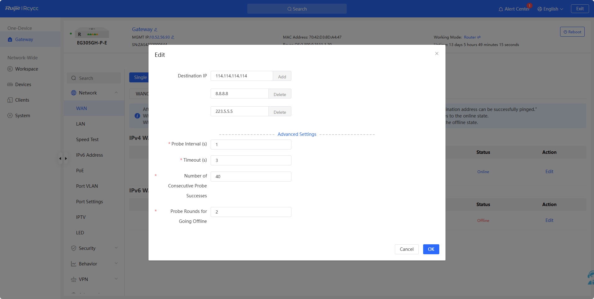

Dear Victor
You can config the Link Probe function, when the port is unreachable, the port will down.
For the config details , you can check here.
https://reyee.ruijie.com/en-global/support/documents/slide_rg-eg-series-routers-reyeeos-2-280-283-configuration-guide/
