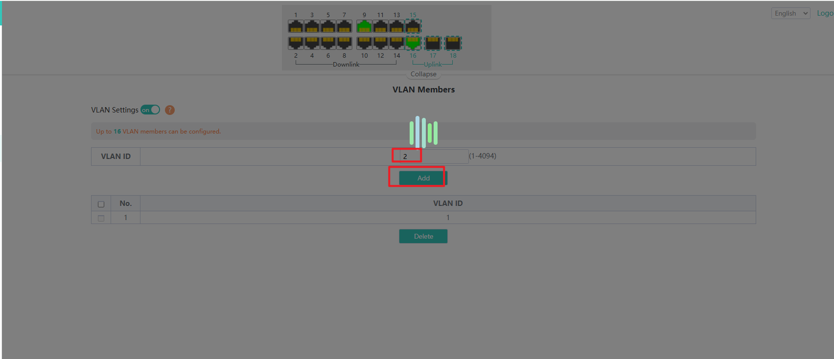

Step 1: Enable the VLAN Settings function(disabled by default)
Step 2: Add a VLAN member

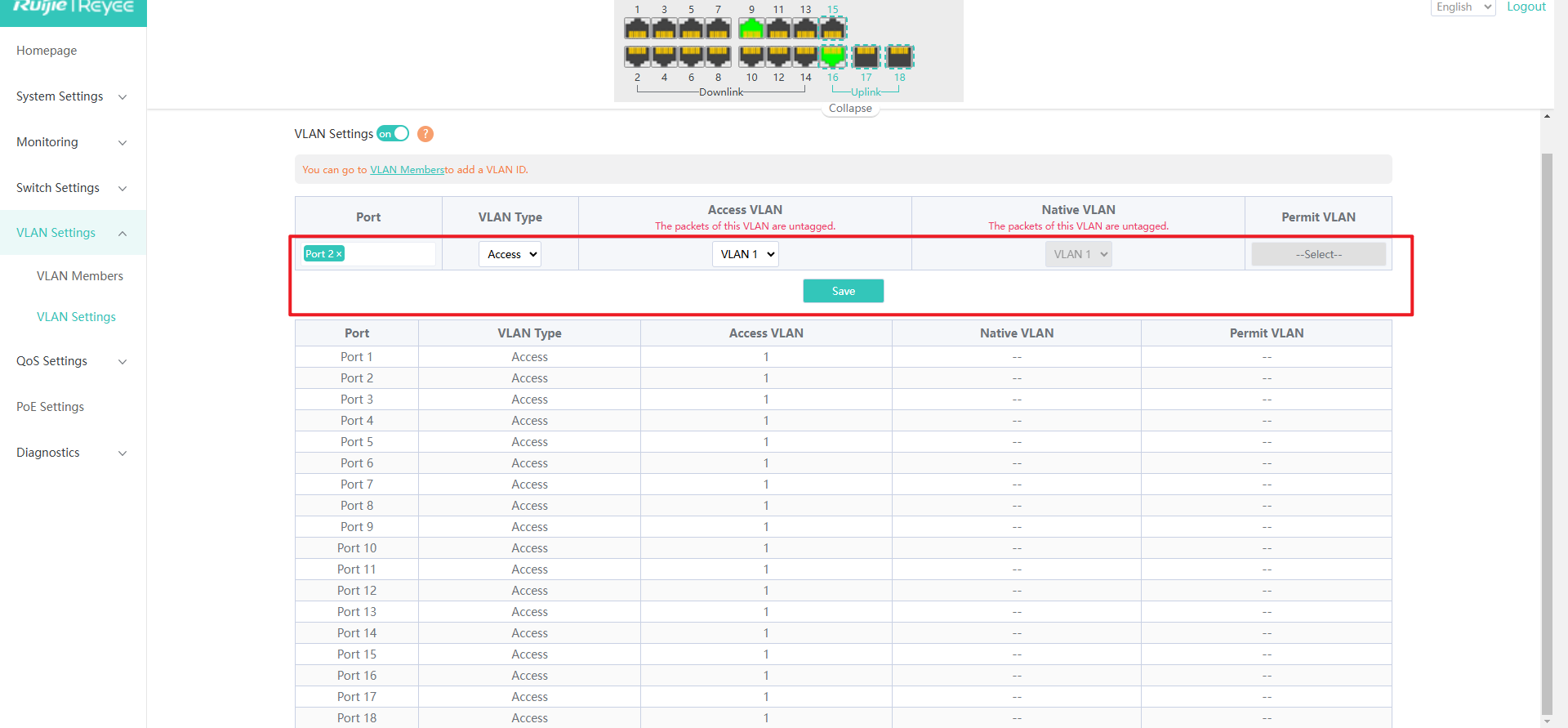

Step 3: Assign the new VLAN member to ports.
For Access port:

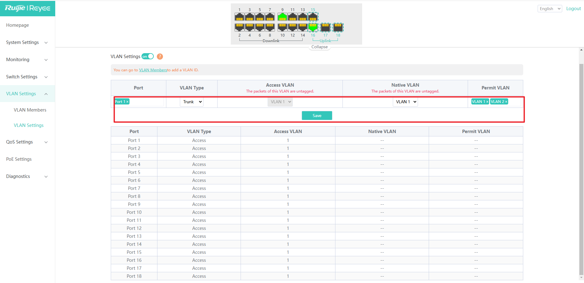

For Trunk port:
