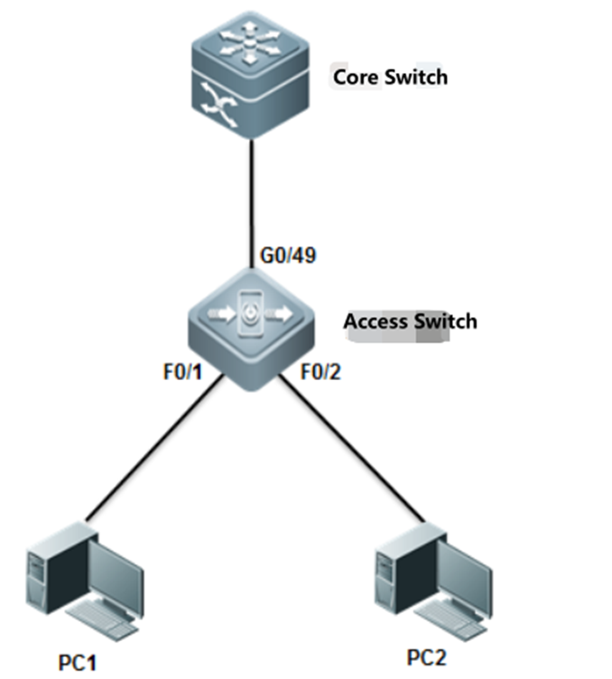

1.Networking requirements
User gateway On the core switch, a DHCP Server is created on the core switch, and the PCS connected to the access switch uses dynamic DHCP to obtain IP addresses. To prevent ARP spoofing between connected users and spoofing the gateway, DHCP Snooping +DAI is used to resolve ARP spoofing.
3. Configuration Points
  • Enable the DHCP Server function on the core switch (clients may also use dedicated DHCP servers, and the core switch only needs to enable DHCP Relay);
  • Enable DHCP snooping globally on the access switch and enable the DHCP Snooping trustinterface on the core port connected to the access switch;
  • Enable the DAI detection function globally, and enable the DAI Trust function at the upper interface;
  • Enable the IP Source Guard function on the interface connecting to the user;
  • Adjust the CPP limit and NFPP function, TRUNK reduction optimization;

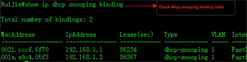

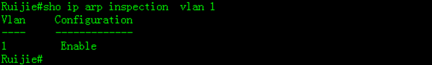

5.Verification function
1. Check whether the DAI function is enabled
2.View the DHCP Snooping table
