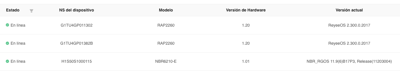

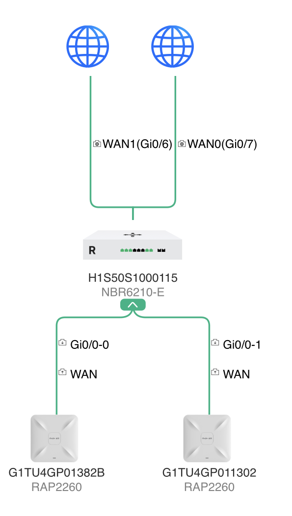

Hello,
I currently have a project with an NBR-6210-E router and two Reyee RAP-2260 APs with 3 Gb capacity. The router is configured as a load balancer for two 1 Gb FTTH lines, and the APs are managed through the cloud. The issue I’m facing is that the maximum download speed I can achieve is only about 350 Mb. When I connect the AP directly to the FTTH router, I can reach 950 Mb.
Both the router and the APs are updated to the latest available version. The router is set up with its minimal and basic configuration, without enabling Smart Flow Control or any additional firewall or similar configurations.
Could you help me understand why I am not achieving the maximum download speed with this setup?

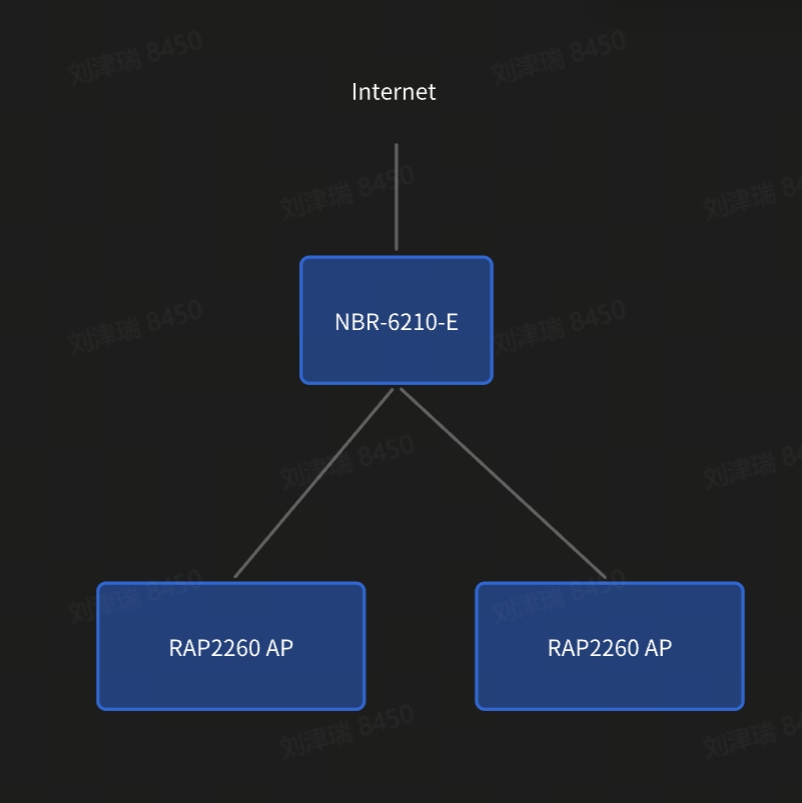

Dear,
I drew a topology diagram for you.
Can you tell us whether the download speed of 350M is from the wireless terminal or the AP monitoring on the cloud?
If it is a wireless terminal, you can refer to the following troubleshooting aspects:
1.AP 's uplink wired port bandwidth is insufficient
2.RSSI value is low
3.Low Wireless Negotiation Rate
4.High channel utilization
5.The distance of the test device test is inappropriate
6.AP configuration incorrect
Notes:
When performing speed test, it is recommended that the test device should be connected to the 5G SSID
and the number of clients who connect to the AP at the saame time is 1-3, then the speed test result will
better.
Ensure that the test device is always within the coverage raange of the AP
Ensure that there are no non- WLAN interference sources on the test site, such as microwave ovens,
Bluetooth, microwave therapy devices, etc. Such devices will affect WiFi signals, causing wireless
connection abnormalities.
0 2024-10-31 00:28:05 View all replies

        •        Connecting the AP to the NBR: When connecting the AP to the NBR, the download speed reduces to 350 Mbps.
Since both the AP and the NBR work correctly separately, I suspect there may be an incompatibility between the AP and the NBR when used together, possibly related to the firmware.
With over 30 years of experience as a network and WiFi engineer, and having implemented numerous successful projects with Ruijie-Reyee equipment, this is the first time I have encountered this type of problem.
I would appreciate your assistance in resolving this issue.
