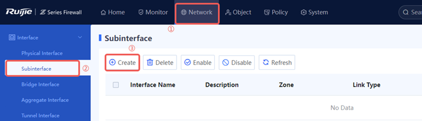

To create a sub-interface on the physical interface connected to the ISP device, choose Network >Interface > Sub-interface and click Create.

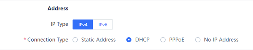

Select a physical interface and set the VLAN ID to 10 (the sub-interface ID is also 10).
Select DHCP to enable thesub-interface to automatically obtain an IP address from the ISP device.
