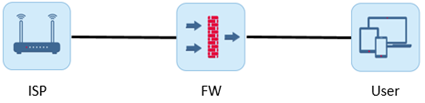

3. Topology

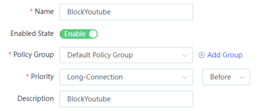

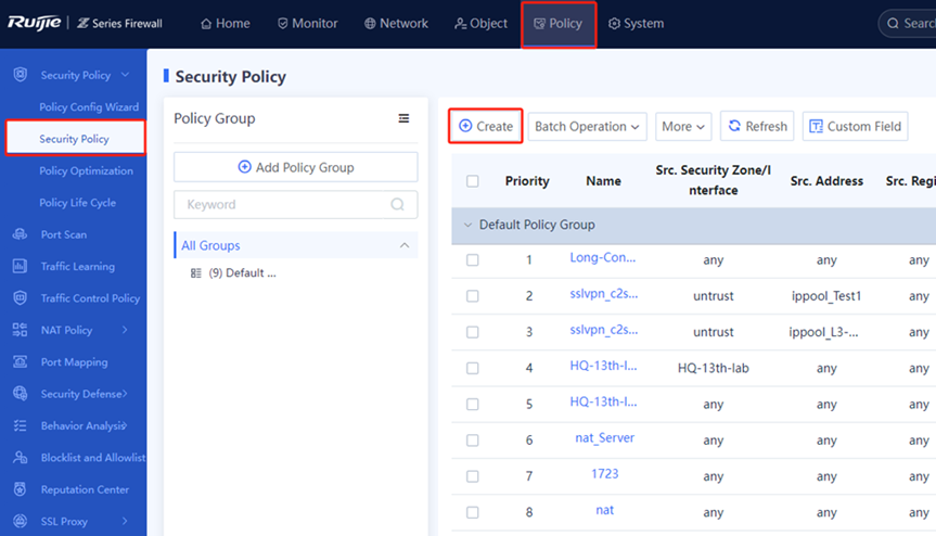

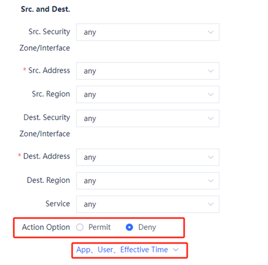

Choose Policy > SecurityPolicy, and click Create to create a security policy.

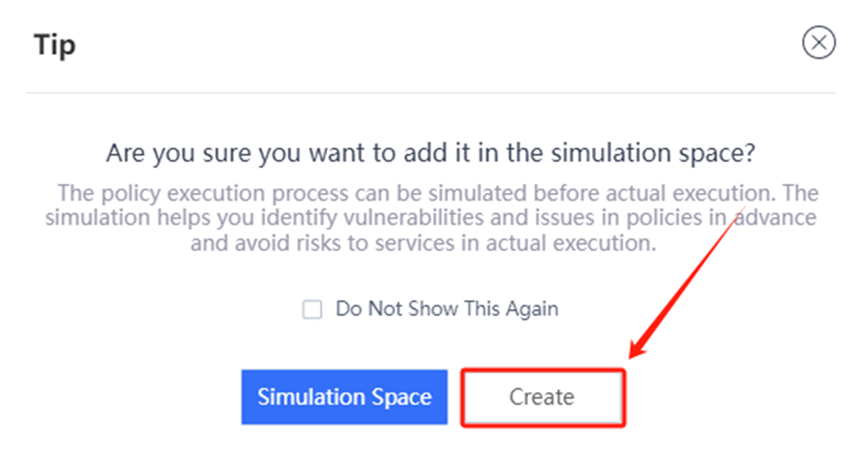

On the pop-up window that isdisplayed, click Create to continue.
The following uses blocking of YouTube traffic as an example.
Basic information:
  Item
  Remarks
  Name
  Name of the security policy.
  Special  characters (e.g.: `~!#%^&*+\/0::”/<>?) and spaces are not allowed.  [Example] Trust_to_untrust
  Enabled  State
  Enable this security policy as required.
  [Example]  Enable
  Policy  Group
The policy group to which the new security policy belongs.
  1.  Select a group from the drop-down list; or
  2.  Click Add Group to add a custom policy group. [Example] Default policy  group.
  Priority
Place the new security policy either before or after the specified policy. Policies  closer to the top have a higher priority in matching.
  N/A
  Description  of the security policy.
  Special  characters (e.g.: `~!#%^&*+\/0::”/<>?) and spaces are not allowed.  [Example] Perform virus detection for the HTTP traffic from security zone 1  to security zone 2.

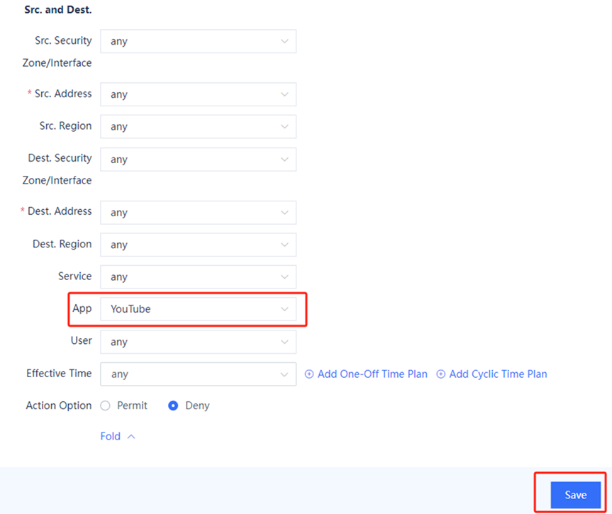

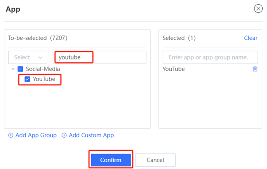

Set Action Option to Deny,and click App, User, EffectiveTime to select the specified application.

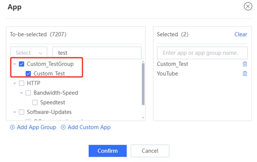

Click App. In the dialog box that is displayed, search for and select YouTube. Click Confirm.

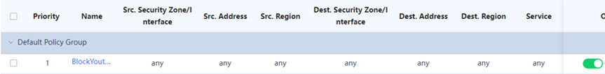

You can also configure the target user, service, source, and effective time. In this example, the policy takes effect for all users and all IP addresses in any time range. Therefore, select Any for all the parameters.
Click Save.

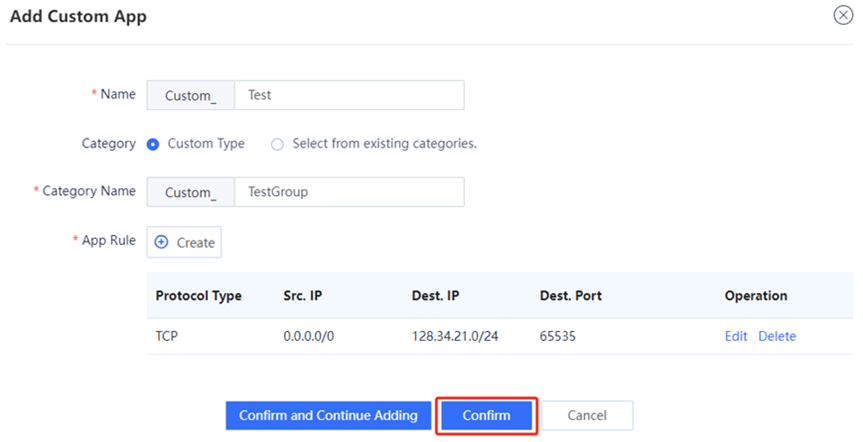

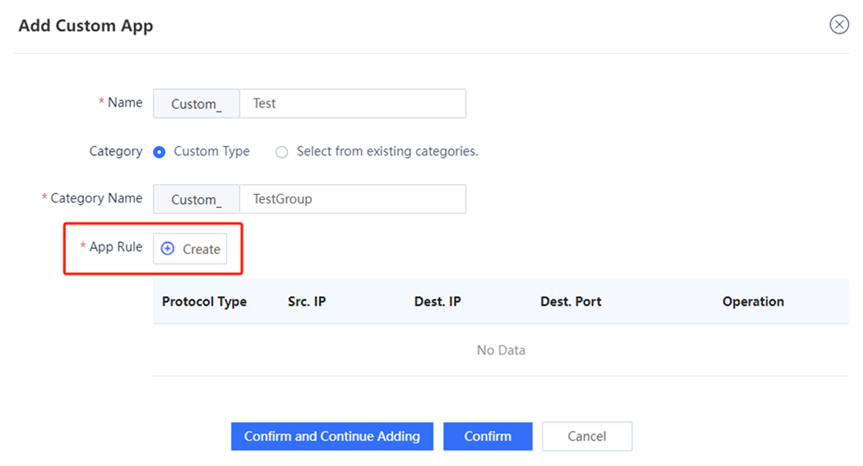

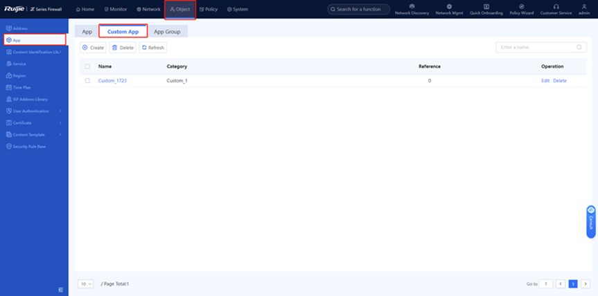

For a custom application, choose Object >App>Custom App, and click Create.
In the dialog box that is displayed, enter avalue in the Name and Category Name fields for the object, and click Create to create an app rule.

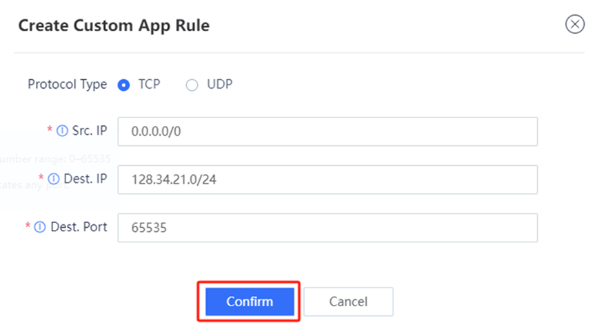

Configure the Protocol Type field and other parameters as needed, and click Confirm.

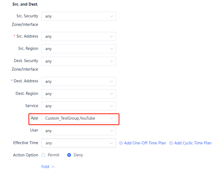

Click Confirm.
Follow the preceding procedures to block traffic from the custom application.
Verification
In the policy list, the policy takes effect, and all downlink users of the firewall cannot access YouTube and the custom application. You can also check the Hit Count field in the command output for verification.
