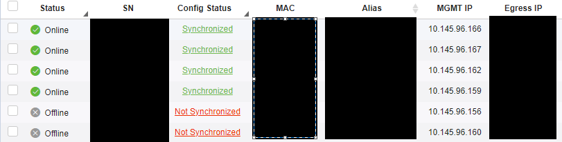

Hello. Yesterday I tried to add a new point to the project, it was offline all the time. For testing, I reset the configuration of two active points and now they are also permanently offline. At the same time, they display their internal and external IP addresses in the project.

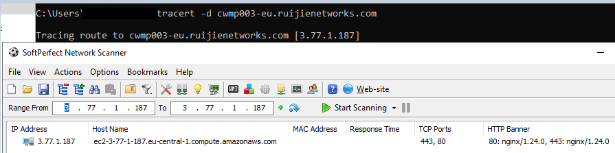

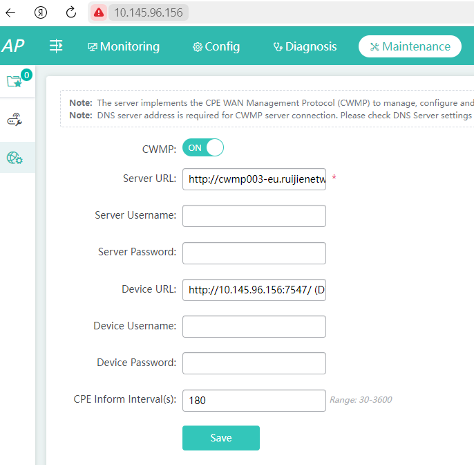

I'll write for others: some models have become available online only in the cloud  wiscloud.ruijienetworks.com.   at the AP, write the line "Server URL" http://wiscloud.ruijienetworks.com/acs
