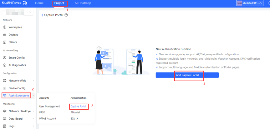

1. Click [Project]-->[Auth&Accounts]-->[Captive portal]

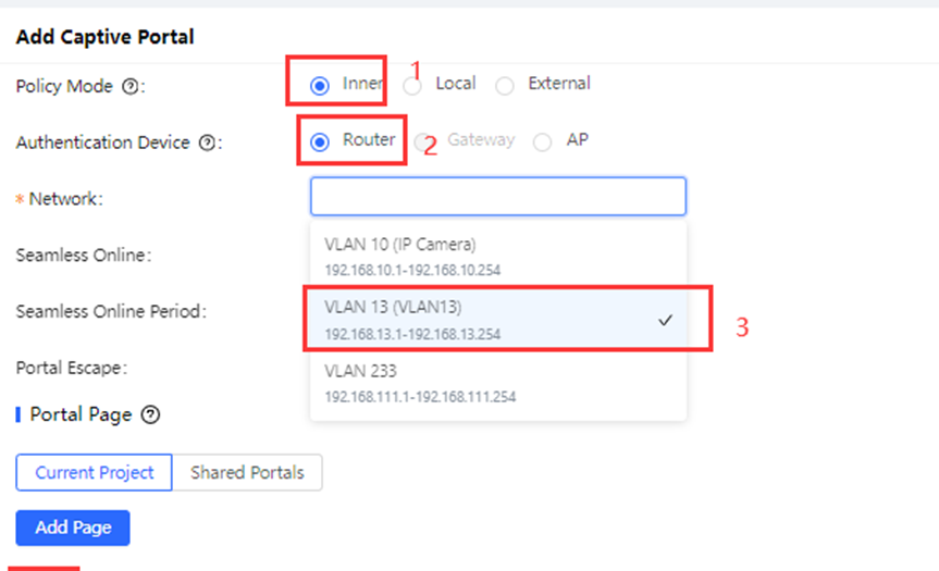

2. Click [Inner]-->[Router]
And choose the VLAN(Ip range) you want to enable the portal authentication

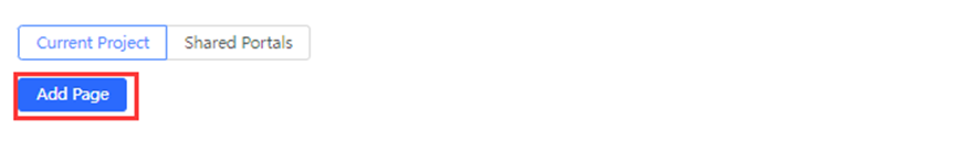

3. Click [Add page]

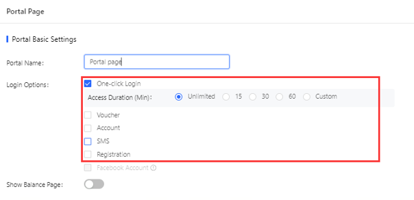

Then you can configure authentication mode and portal style
4. Check whether the portal status and VLAN (ip range) is correct
