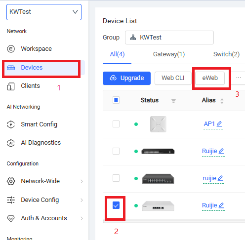

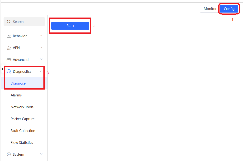

Dear user,

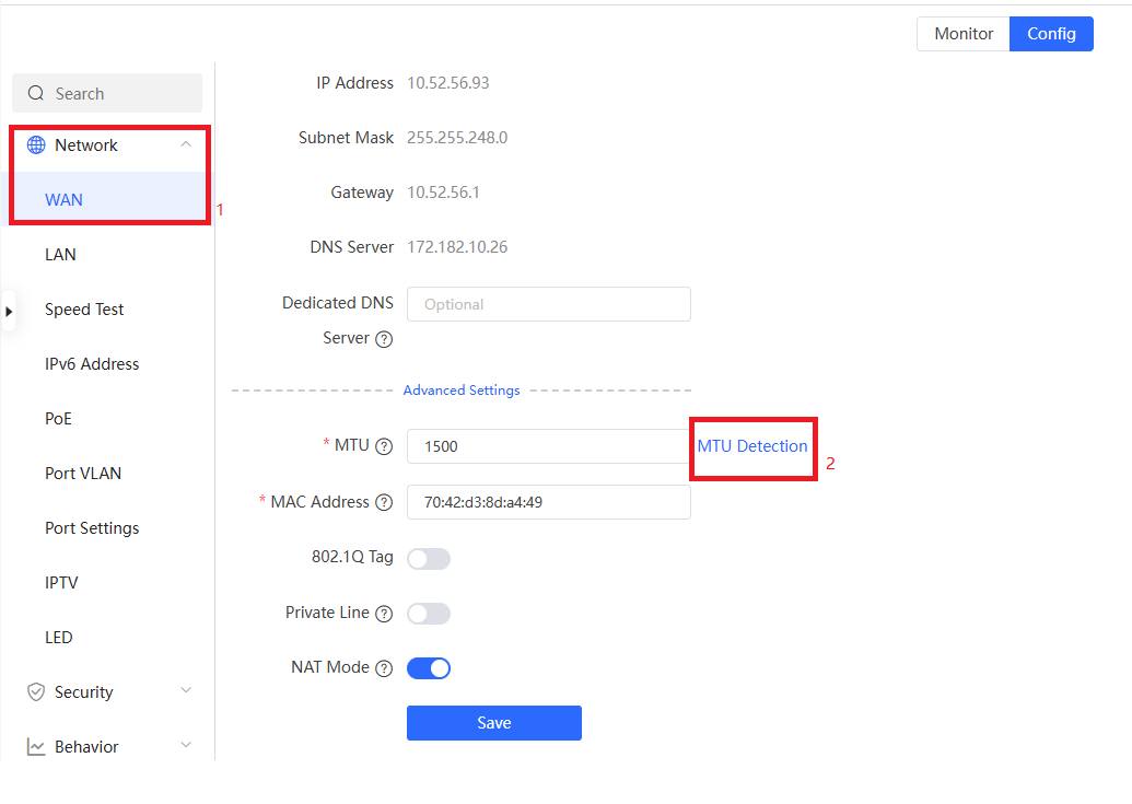

The abnomal link on the WAN port is likely to the the incorrect MTU settings in the WAN port. Could you run the diagnosis in the eweb of the device? It will provide more info regarding the warning.
If it is due to the incorrect MTU settings, you can detect the optimal MTU and set the MTU to it.
