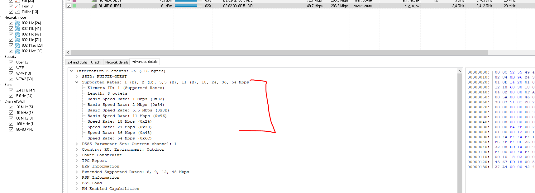

Hello.
Could you please explain how to correctly disable low basic rate on fit AP.
We have:
AC6108, AC_RGOS 11.9(6)W2B1, Release(10162720)
AP AP840-I(V2), AP_RGOS 11.9(6)W2B7, Release(10150919)
AP680-O(V3), AP_RGOS 11.9(6)W2B4, Release(10171714)
Our problem is that the access points continue to broadcast low basic rate in 2.4.
Although they are disabled in the configuration file.
The problem exists only for the 2.4.
It is also strange that the "802.11b network rate 1 disabled" command is applied in the "ap-group default" section, but does not appear in the configuration.
Thanks!
