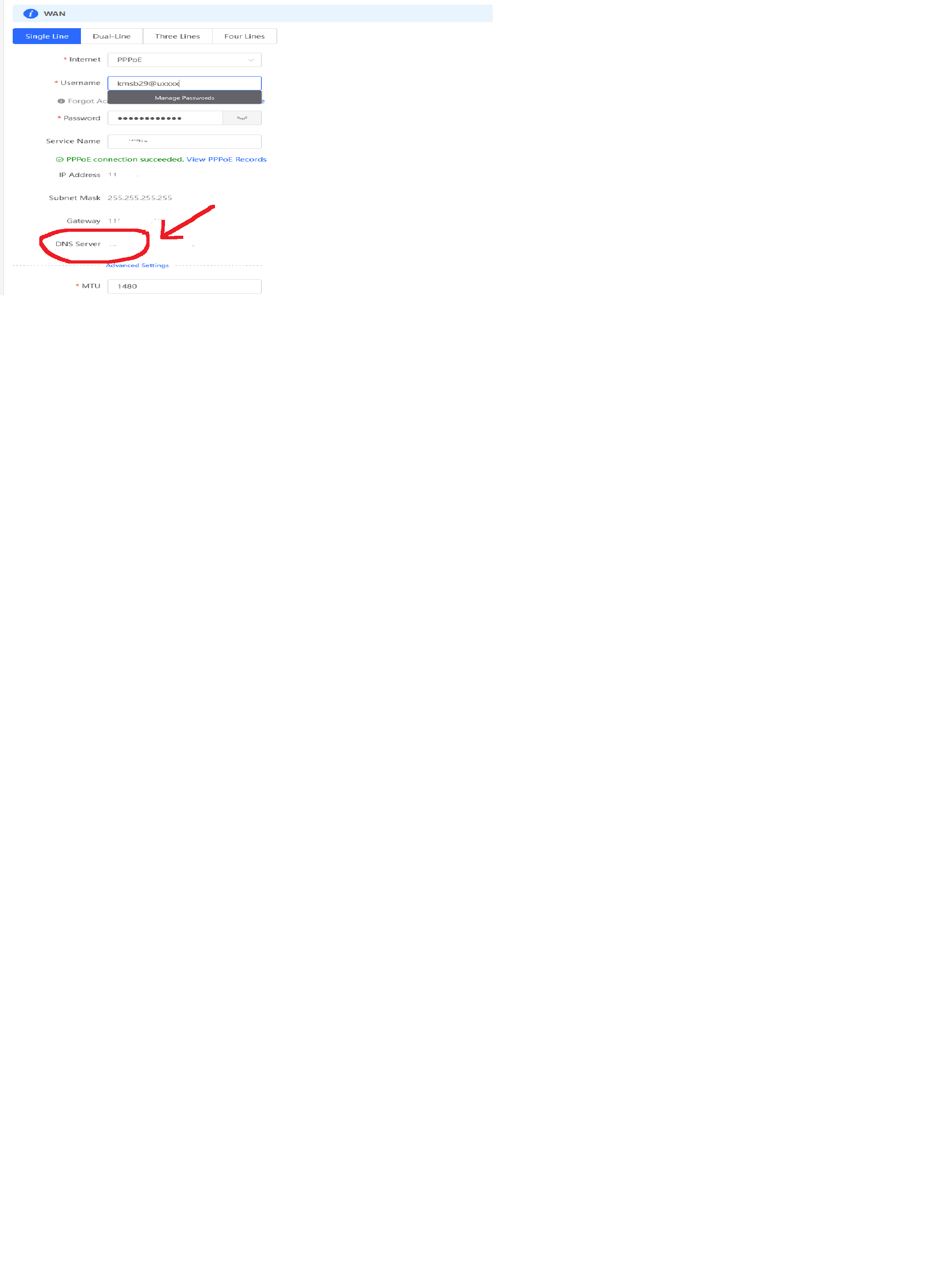

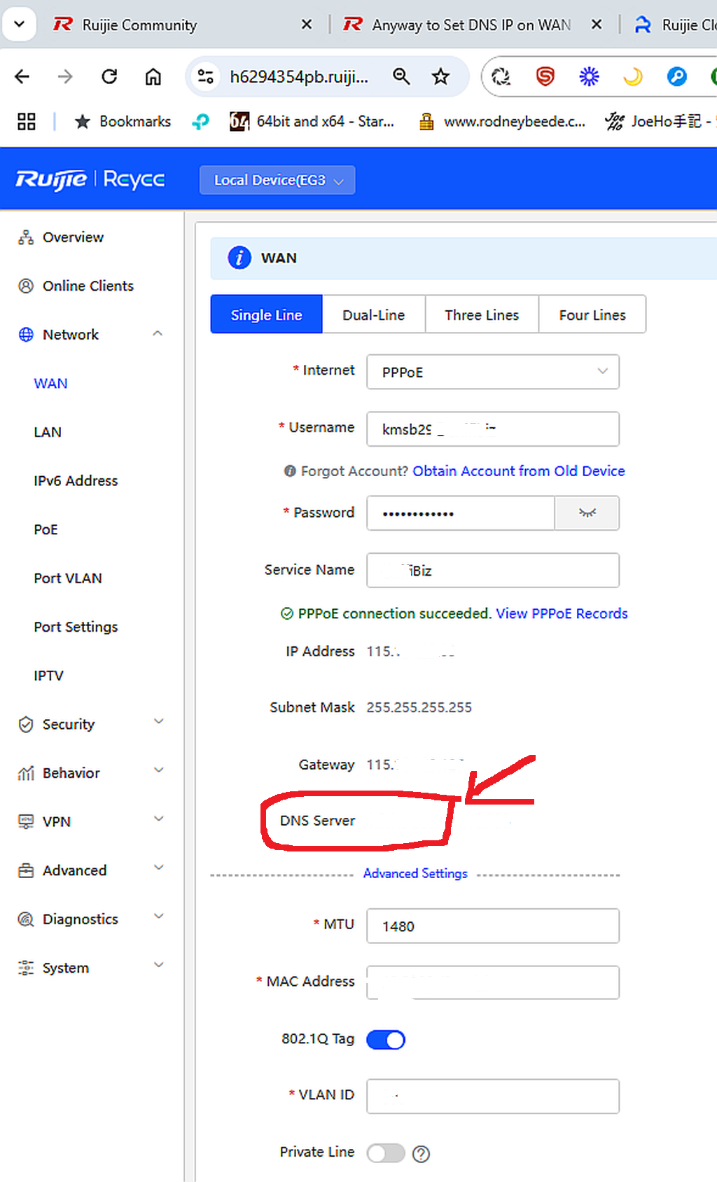

Hi Sir /Mdm.
Good day to you ! is the anyways to Anyway to
Set DNS IP on
WAN Port of RG-EG305GH-P-E? as show attachment picture below , thank you
WhereBy Home Gouter or Reyee able to Set DNS IP on WAN Port setting
RG-EG305GH-P-E
Others Router

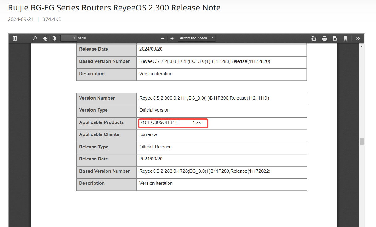

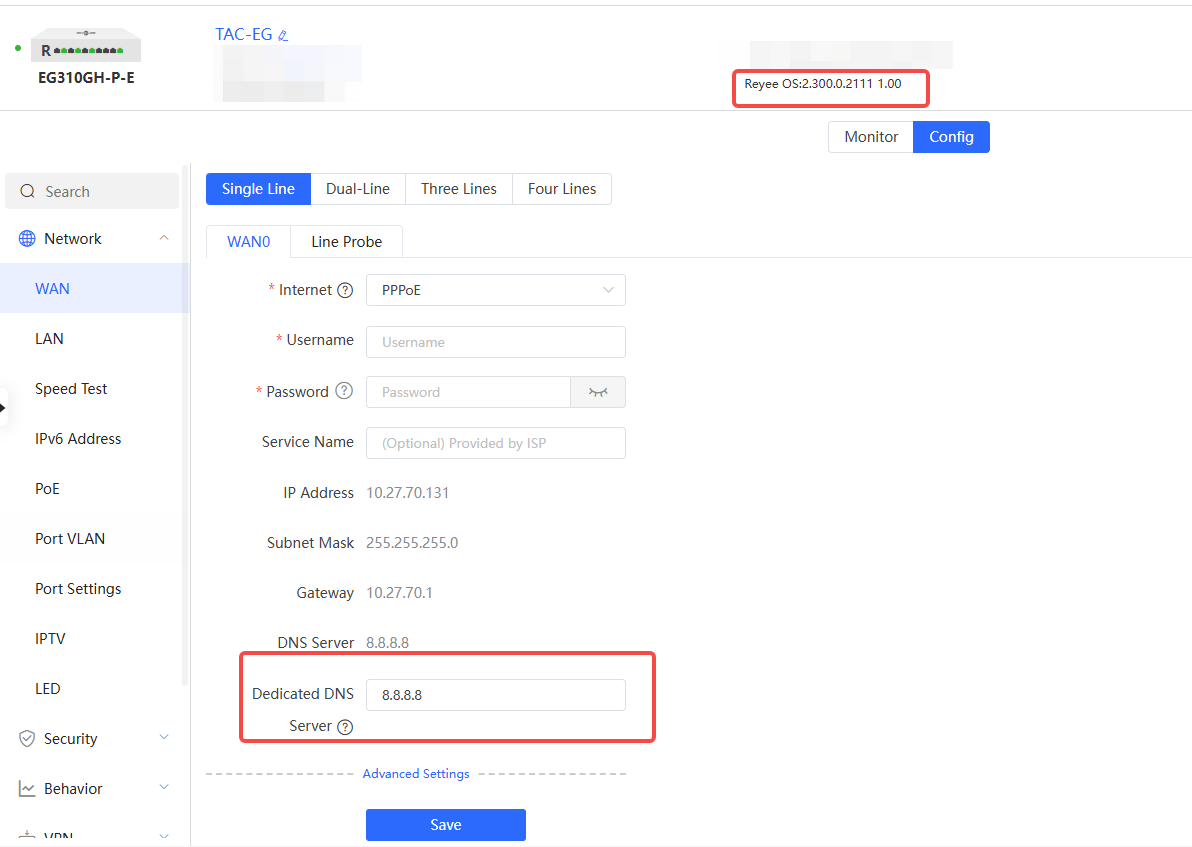

Can you please try to install the latest firmware version, you can obtain from here
https://reyee.ruijie.com/en-global/resources/software/rg-eg305gh-e-firmware/305gh-e-300-firmware/

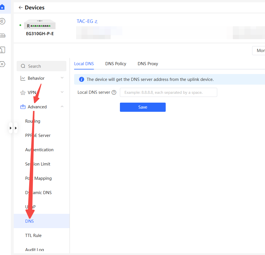

also in the advanced setting you can set a local DNS
After the update you must be able to set a dedicated DNS server
Regards!

Dear TAC-Saul,
Noted with thanks for your good help , now  set a dedicated DNS server
after upgrade
Thank you
