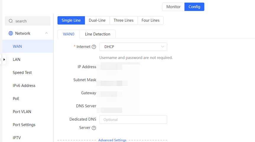

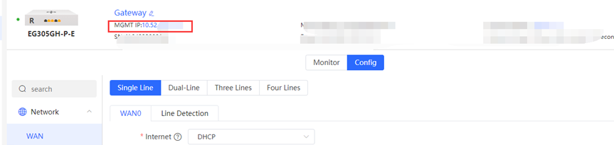

1. Check whether devices from both ends have obtained the public ip address
(If the IP address is a public address, you can ping the management IP address of the device even if you do not access the device locally. However, it is not ruled out that ISPs will prohibit ping)

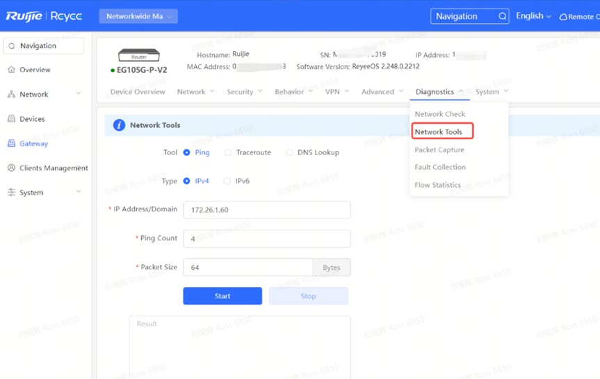

2. Check whether the device from branch and HQ can ping with each other
And if they can ping the ip address 8.8.8.8too(we can use the Network Tools on the device)
Note:
Need to check whether device disable ping on both ends

Check the WAN port configuration, whether the device has obtained the public ip address( PPPoE/DHCP/Static), whether the VLAN tag needs to be configured. If a device can not access the network,we need to confirm with ISP side to make sure there is no network issue

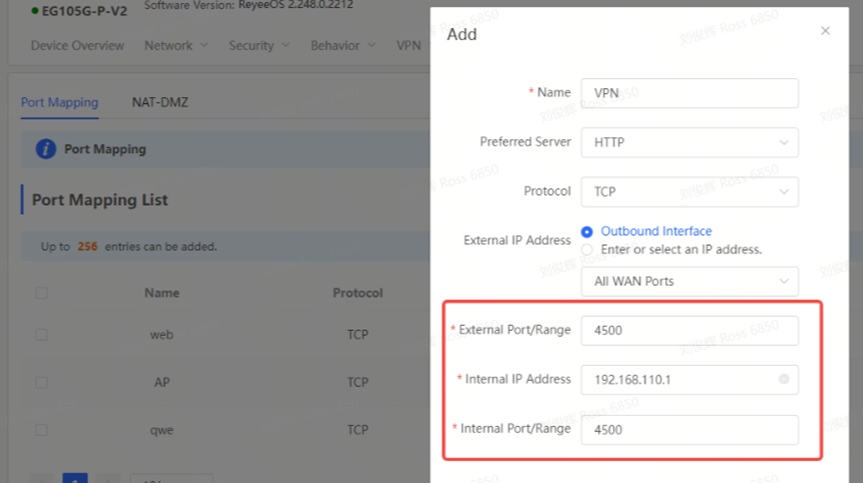

2. If a device works in the secondary NAT environment, not obtain the public ip address
For example, when a device only acquires a private IP address, it is essentialto configure port mapping on the upstream device to forward the VPN port of the downstream device.
Additionally: you may need to set upa DMZ on the upstream device to forward all ports to the downstream devices.
Port mapping:This configuration is configured on the upstream device, not on the device that has obtained the private network address
The following is the port mapping configuration, which is similar to the port mapping configuration of other manufacturers
