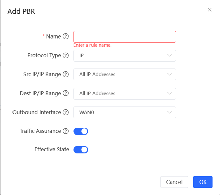

  • Check the version of EG. Please upgrade it to the latest version if it is using the old one.
  • Check the configurations. Make sure the settings are correct

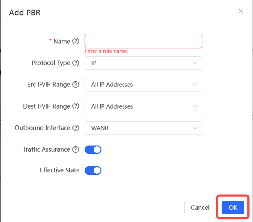

  • Remember to click OK so the settings can be saved.

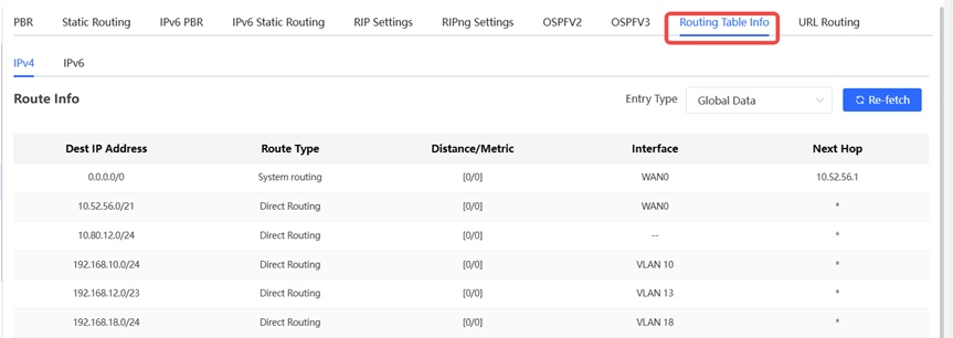

  • Check the route table and confirm if it is listed here. If not, please try to changea ip range and test if it can work
