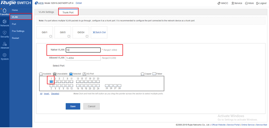

b) Configure native vlan on the switch port viaeweb:
For example, configure vlan 10 to the native vlanon interface G0/1:
Click VLAN> Trunk Port, select a port,specify Native VLAN and Allowed VLAN, and click Save. The "Configuration succeeded." message is displayed. In this case, the newly added trunk portis displayed in the trunk port list.
