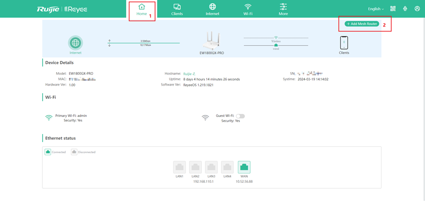

1. After Connecting to the Router, clickHome--->Add mesh Router

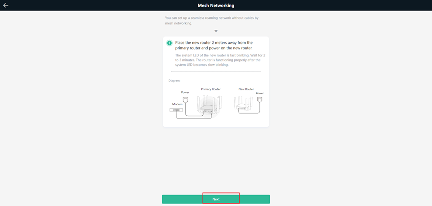

2.Click next

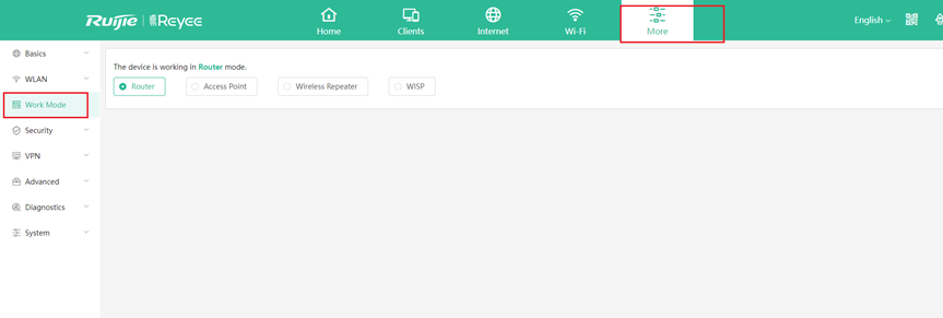

Note:This function is supported only in Router mode. You can check it here
