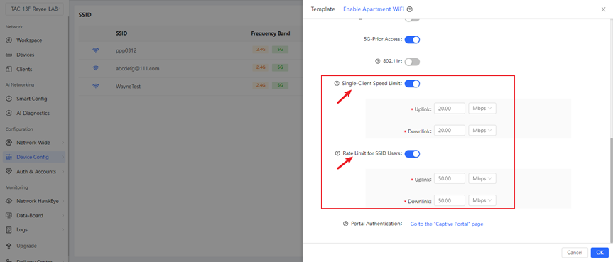

Single-Client Speed Limit:
It indicates the upload and download speed limit for each client on this SSID. If the Single-Client Speed Limit is set to 20Mbps, all users can obtain a speed limit of 20Mbps.
Rate Limit for SSID Users:
It indicates the total throughput (upload & download) on this SSID. If the Rate Limit for SSID Users is set to 50Mbps, users in this SSID share 50Mbps in total.
As shown in the figure above, all users are limited to 50Mbps, but individual users will not exceed 20Mbps
Due to the uneven distribution of bandwidth, some users may take up a lot of bandwidth, resulting in a poor Internet experience for other users, so limiting a single user to 20Mbps can avoid this phenomenon.
