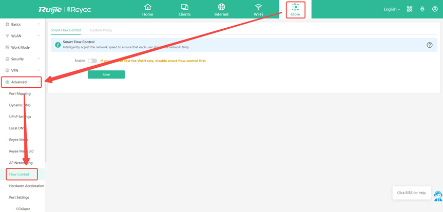

Choose More> Advanced > Flow Control > Smart Flow Control:

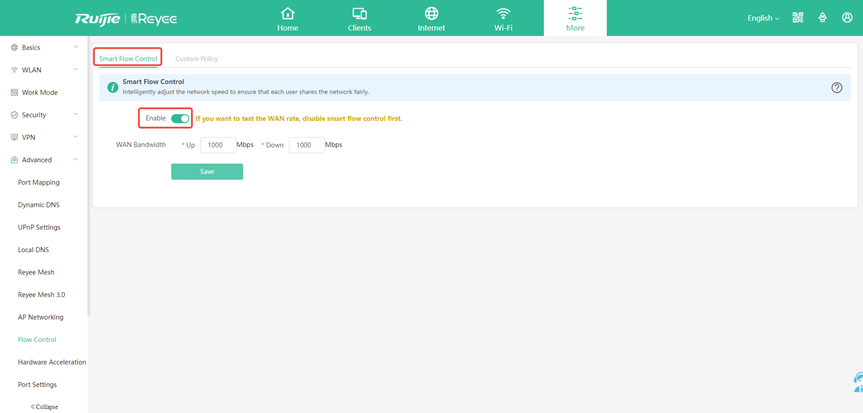

1. Enabling Smart Flow Control:
Click Enable and set the network bandwidth provided by the ISP. After the configuration is saved, the router adjusts the bandwidth of each client based on the total bandwidth to prevent anyone client from occupying too much bandwidth.
Note:
After smart flow control is enabled, speed measurement will be affected. Disable flow control if you want to do speed measurement.

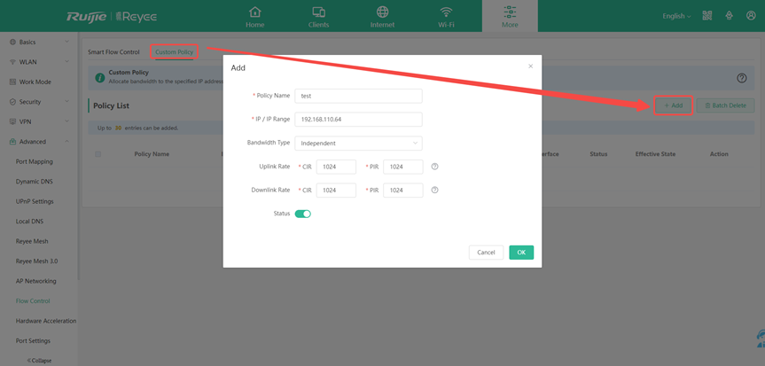

2. Custom Policy
You can configure custom policies to allocate bandwidth to specific IP addresses/ranges to meet the bandwidth needs of specific users or servers. Click Add on the Custom Policy page to set the policy name, specific IP address/range, bandwidth type, and uplink/downlink rates.
The following picture depicts an example of limiting the bandwidth of 192.168.110.64 to 1Mbps at both uplink and downlink.
Bandwidth type: Shared indicates that all IP addresses share the total bandwidth. Independent indicates that the rate limitis set per IP address.
CIR indicates the committed information rate.
PIR indicates the peak information rate.
