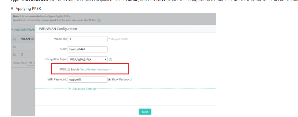

Hi all, I new in Ruijie, I have a question about product i will buy
Can AC model RG-WS6008 use PPSK authentication feature?

Hello,
Yes this model can support PPSK. Here is the configuration guide if you need: https://www.ruijienetworks.com/support/documents/slide_rg-wlan-series-access-controllers-web-based-configuration-guide/#_Toc164350923:~:text=1.3.3.1.2-,PPSK%20Management,-The%20dynamic%20pre

Hi Huy Doan,
Yes, the Ruijie RG-WS6008 AC supports PPSK (Private Pre-Shared Key) authentication. This feature is typically available in Ruijie's wireless access solutions, including the RG-WS series controllers. However, to ensure compatibility, you need to verify the following:
  • [strong]Firmware Version[/strong]: PPSK functionality might require a specific firmware version. Check if the RG-WS6008 is updated to the latest firmware that supports PPSK.
  • [strong]Access Point Configuration[/strong]: PPSK often works in conjunction with compatible Ruijie access points (APs). Ensure that the APs you plan to connect to the RG-WS6008 also support PPSK.
  • [strong]License Requirements[/strong]: Some advanced features like PPSK might need additional licensing. Please verify if an extra license is required for your setup.
