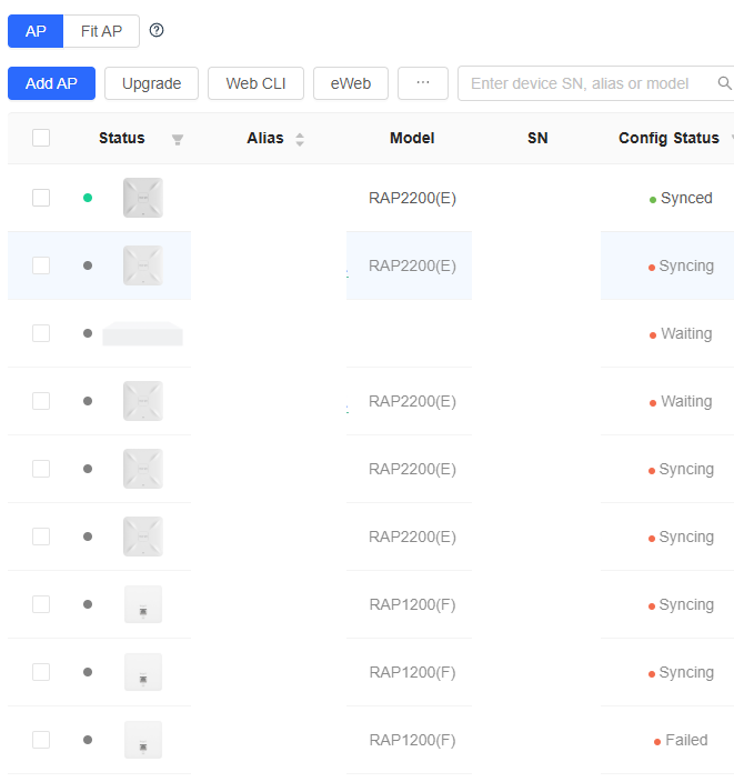

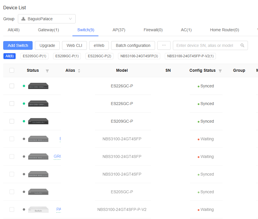

Hi, my APs and Switches appear offline on the cloud. Locally, they can be pinged and their management interfaces can be accessed.
Please see screenshots for specific models:

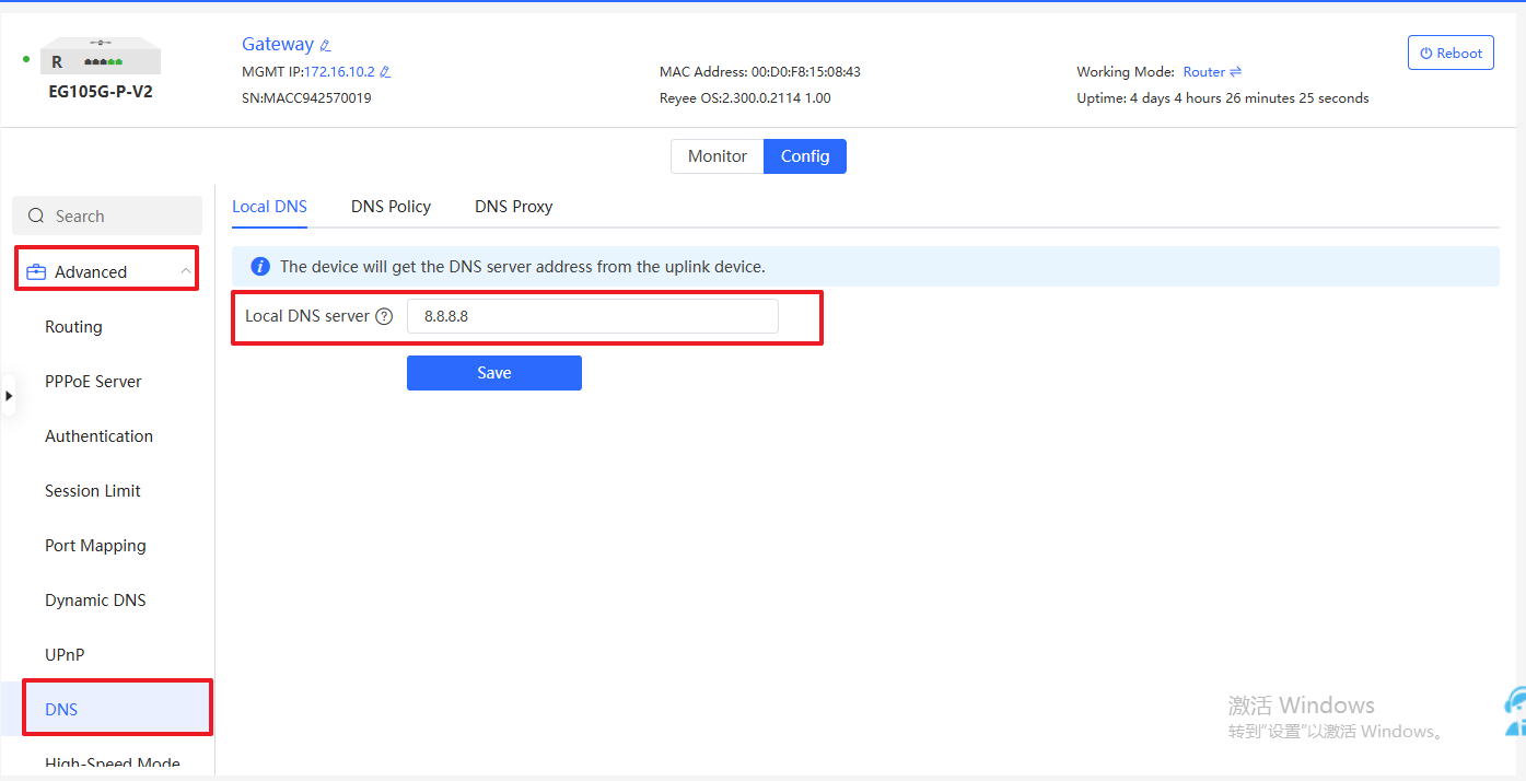

If you can only ping through an IP address, but can not ping through the domain address. Please try to change the device DNS server address to 8.8.8.8 via Advanced > DNS to test again.
